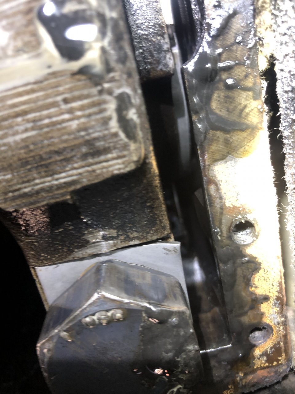

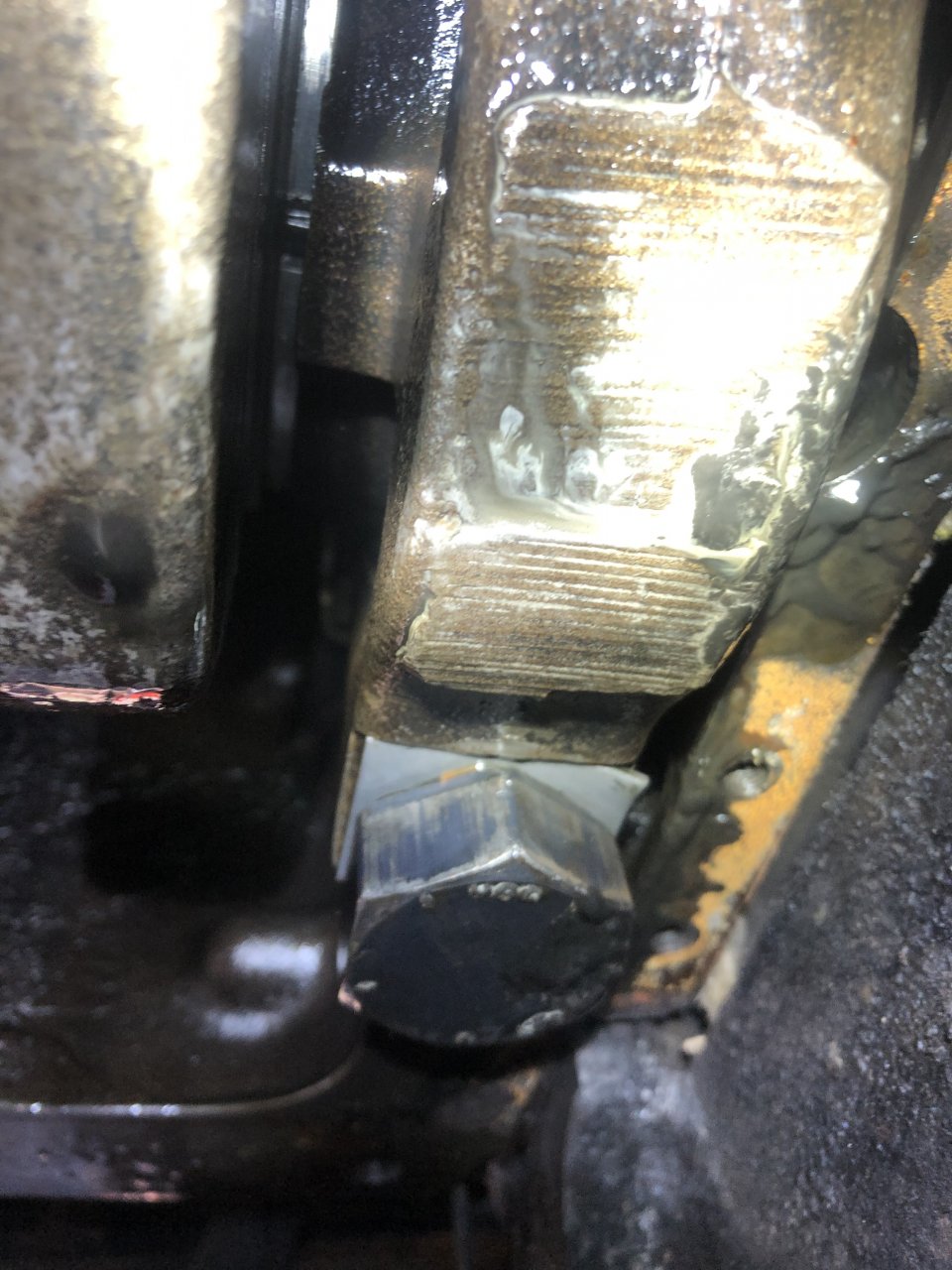

    OK so I’m under here looking at the crank and on the back of the engine it looks like there is a thrush washer on both sides, see images….and on the front it appears that there’s nothing there. The crank moves back-and-forth maybe a 16th of an inch. My questions are does both ends of the crank get a thrush washer or is it just the back of the motor on an MTC 350 small cam 1976?
    Also Does it matter which Rod and Main cap I pull to start As long as I document everything?

    IMG_3152.jpeg Back of motor

    Front of motor

    If I’m looking at this correctly on the back of the motor, there are 2 thrush washers with little metal pins in the bottom of them to hold them in place on each side but I don’t see anything on top of those?
    is the tops what’s missing? Or should it only have bottoms
    Both bottoms are clearly on there and clearly intact
