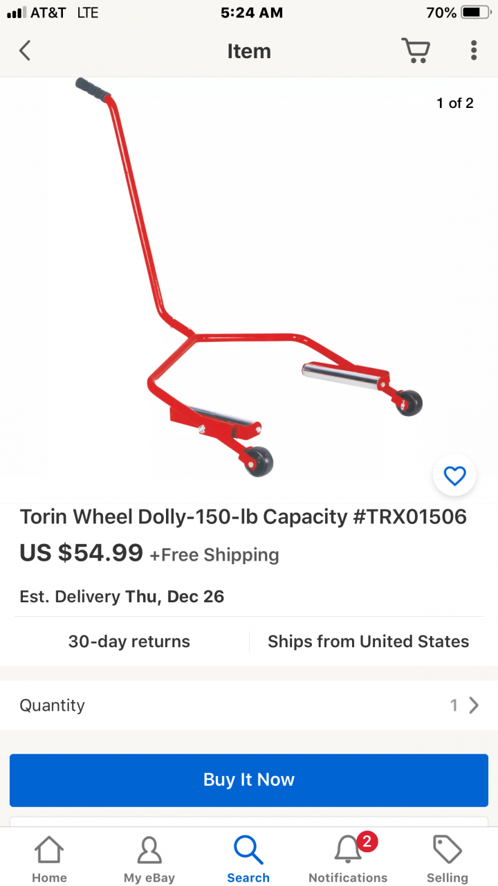

    Real tire guys will call you a sissy, lol! But these work ok . I have one at my shop , but mainly use pry bars or tire irons to move tire/ rims on and off .
