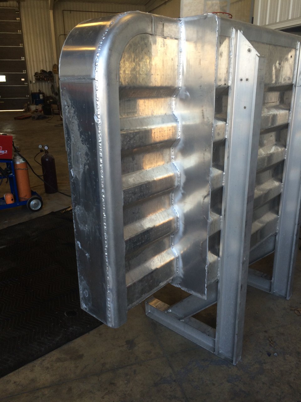

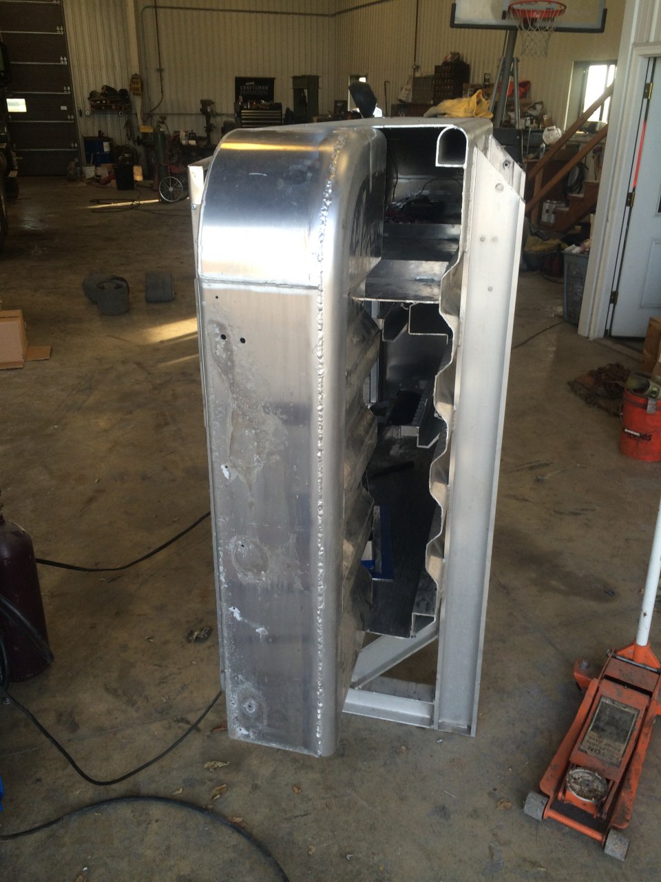

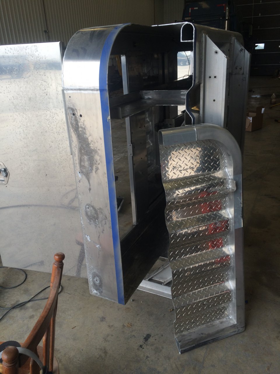

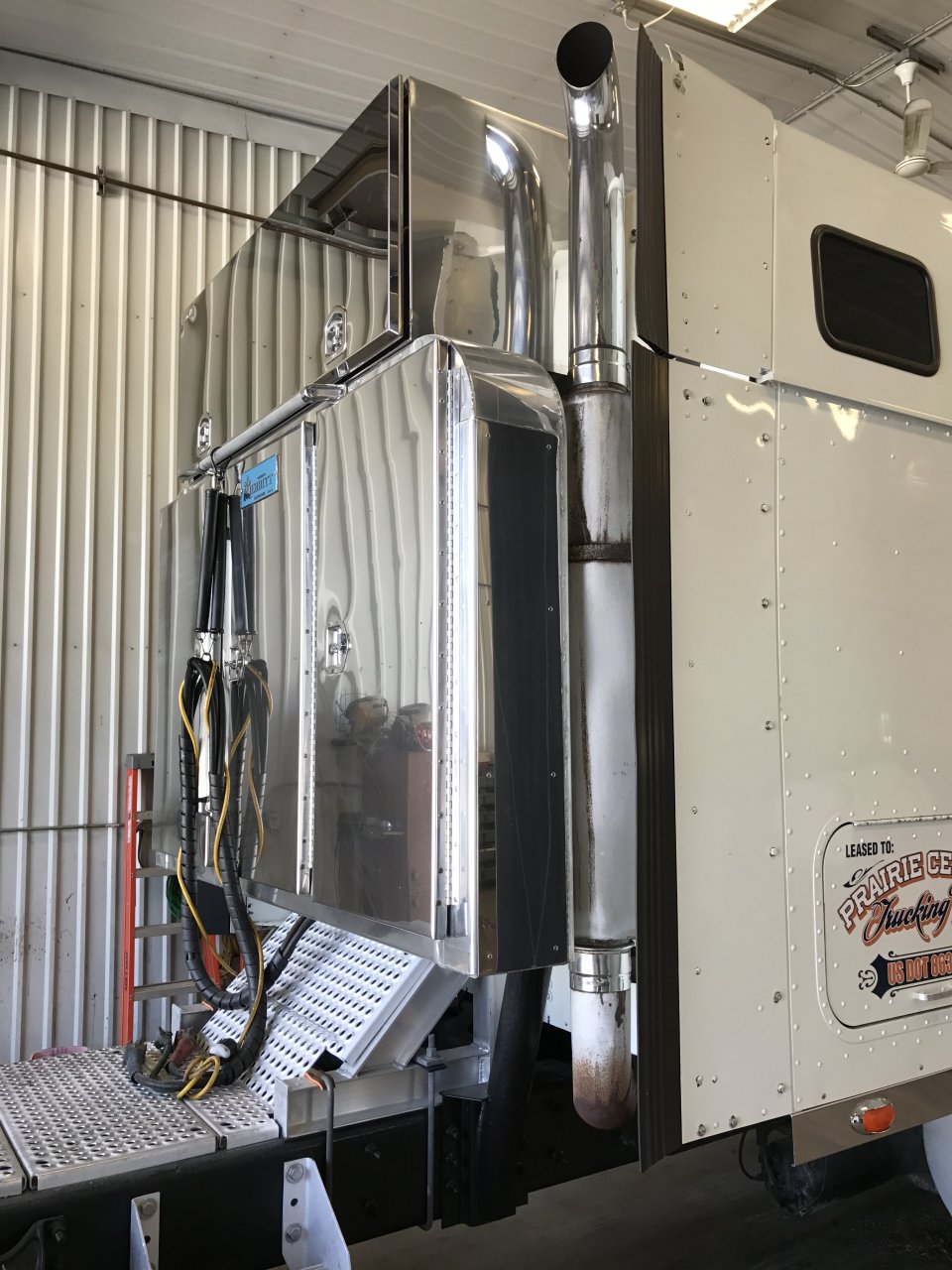

    I notched out my cabinet to fit around the stock system. I am close to pulling the trigger on buying another used mount for the other side and doubling them up behind the sleeper. The factory side stacks use a bracket under the cab and one up high on the sleeper. If it didn’t come from the factory with side stacks it is hard to retrofit them. If it was easy mine would already have them. DFCE3D48-3B62-46E3-8FD9-73DED867E909.jpeg 10478A61-1E64-4675-A09E-02546CF6ABF5.jpeg EF2CFF05-3F86-464C-B941-CBBD199AA8D9.jpeg 16444DFE-87C3-49D1-98DF-87679A710680.jpeg

    That’s a pretty slick setup! Looks nice and clean.
