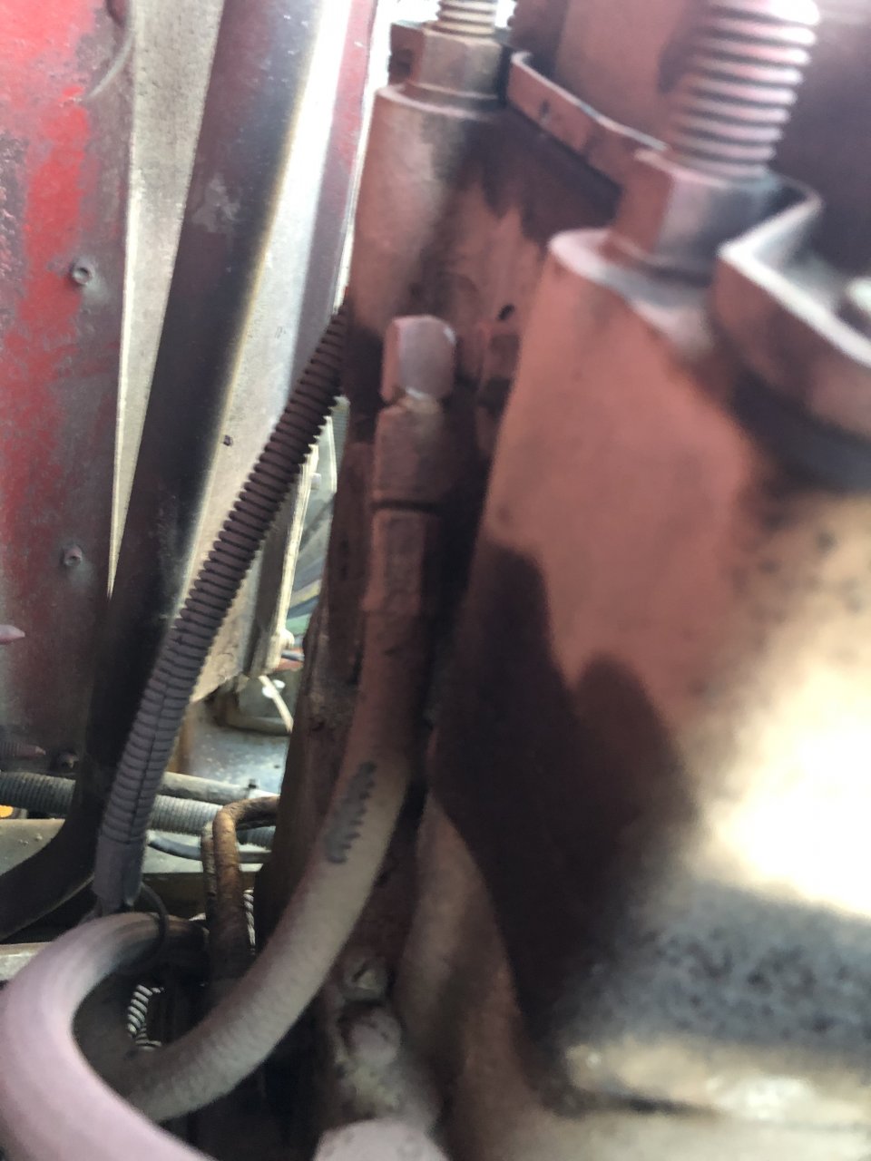

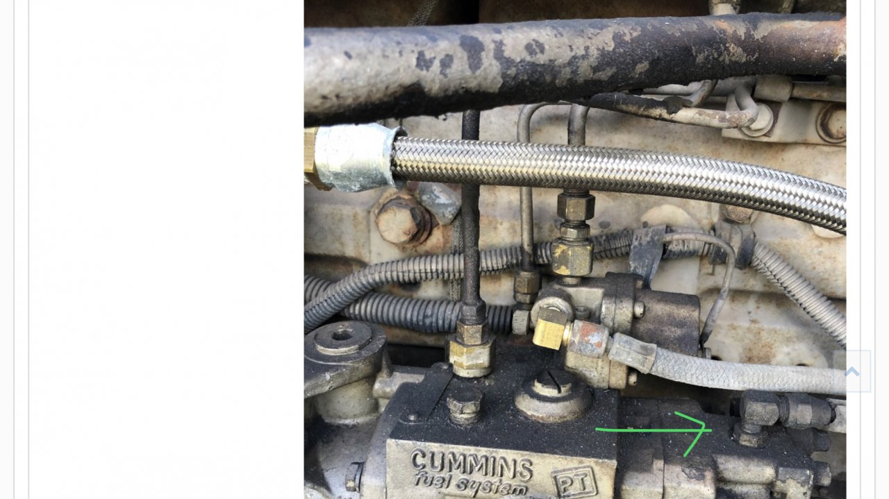

  5. 88NTCINTERNATIONAL
    88NTCINTERNATIONAL Bobtail Member
    13
    2
    Sep 12, 2019
    the one you are pointing to does T into the return line (one side goes to the port just to the left of the shutoff solenoid) and the other side to the back of the head (just next to the fuel supply).
    The other line, that comes from the port where I will be getting my fuel pressure from, Goes to a box that I took a picture of, the smaller diameter line that comes from it goes to the back of the head also (but above the supply and return) the larger line goes to the STC.
    What is the line going to the head above the fuel supply/return for?
    Also, where would you start to diagnose my power issues?
    Thank you for all your help,
    Shane

    629A3554-30D4-406F-8167-812154EA908A.jpeg Are you talking about this line? It should go to the other port on the top of the pressure head right above were you need to install the gauge.

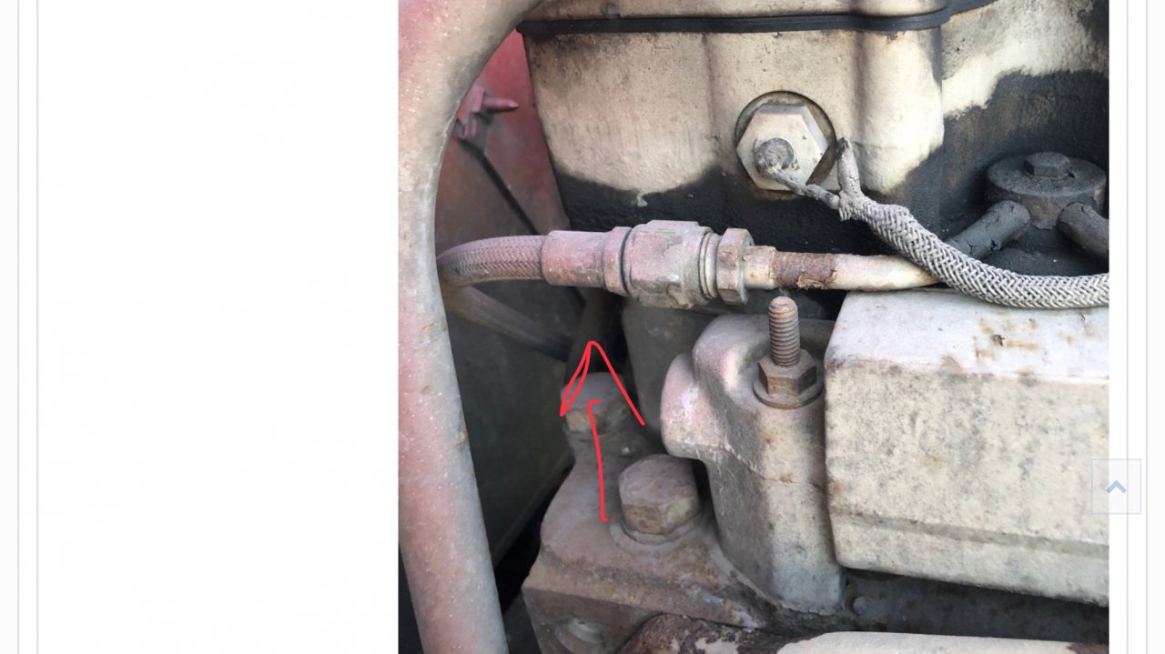

    it comes from the box that is supplied by the port on the side of the fuel cut off solenoid. My question is, what is this one for? I’d like to just bypass this and run one signal to the STC directly...
    I’ll try what you guys are saying and see how it goes, thanks again for the help
    Shane
  10. SmallPackage
    5,511
    17,565
    Dec 20, 2019
    Marion Texas
    Its part of the stc. It will not run good without it. You are gonna have to tee it.

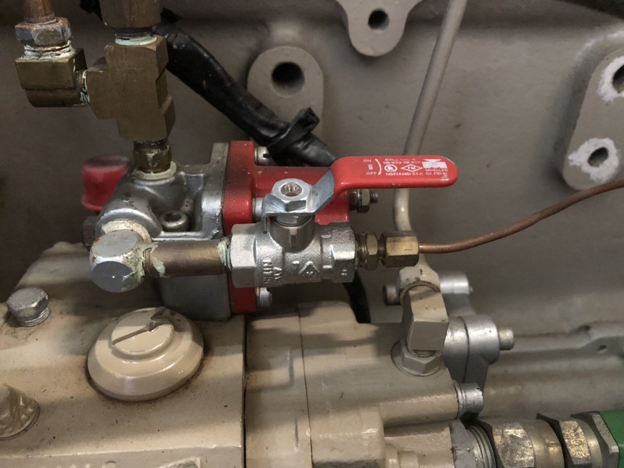

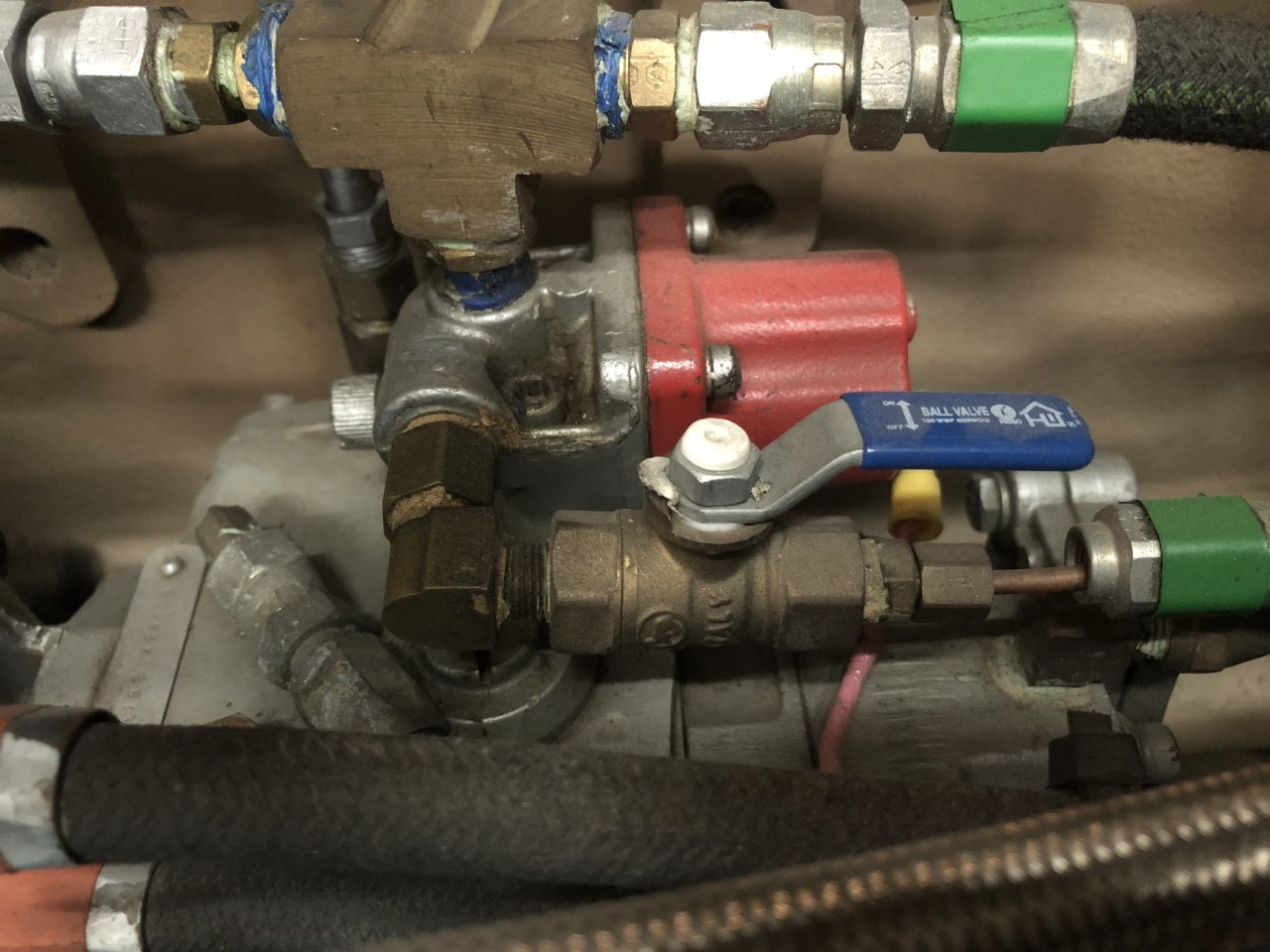

  11. SmallPackage
    5,511
    17,565
    Dec 20, 2019
    Marion Texas
    BC56B1F3-381A-4336-BD26-21F01690C2F2.jpeg F34C571B-7C6F-443F-A8E8-922E0115D373.jpeg This is how I did two of mine. I have fuel pressure gauges in the dashs of all my trucks.
