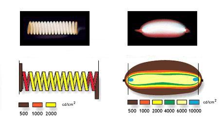

    Here's why your advice is wrong, and dangerous:
    The filament in a halogen bulb emits light in a different pattern and intensity concentration than the arc bulb in an HID headlight assembly:
    The left shows the shape and emission properties of a halogen filament, the right shows the shape and emission properties of an HID capsule arc.
    The optics of the headlight housing are designed to redirect and distribute the light produced from each of the emitters respectively. They are quite different from each other. Using a bulb that's not designed for the housing will be a safety issue, as the light will either be insufficient for good visibility (already a problem with the Volvos), or will irritate and / or blind oncoming drivers.
    Also, using the HID 'conversion' bulbs and ballasts as a drop in replacement for dual filament halogen bulbs will disable the high beam function. You will only have low beams.
    Please do some research before recommending modifications to safety sensitive equipment on CMVs.
