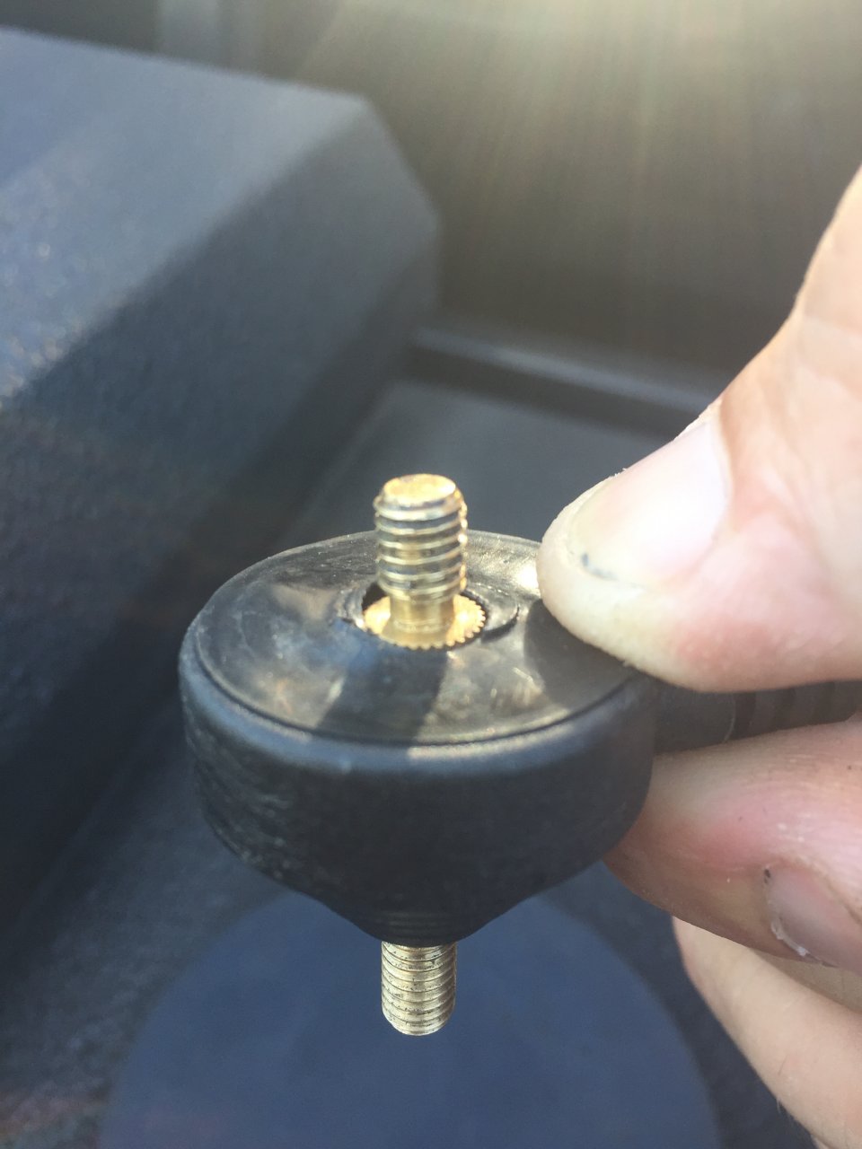

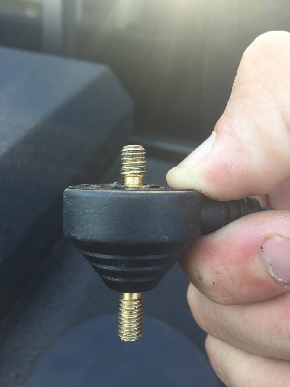

    Ok, now I know what shielding is. But on the antenna side of things i cant get to any of that. Heres a pic of what i have available at the antenna. Can i test something at the radio connections? Sorry im being difficult, new to these radios.

    The bottom stud at the antenna end to the top stud... no beep on your meter.
    The bottom stud to the barrel nut should beep.
    The top stud to the center conductor should beep.

    Try this, just to see what's what.
    Take a peice of wire and short out those two studs. Then check the connector end just like rabbis image shows you, you should get a zero reading. If you don't then we may have an issue.
