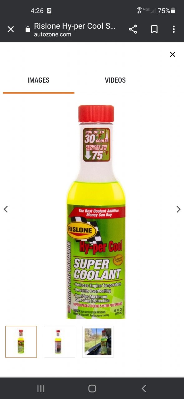

I've used this " Water Wetter" in some cars in the past.Have some diesel versions. Would probably be best just for summer use . I'm not sure of the ideal mix, you'll have to read up on it, but some racers use it with distilled water only.It doesn't seem to work well with 50% antifreeze. I'd probably drain it ,run about 30 to 40% straight antifreeze + 10% water wetter and the other 50% distilled water. Like ,I say ,I'd read up on it, but in some cars I had it would make it run 10 to 15 degrees cooler on the gauge in the hot summer,with AC on even.
