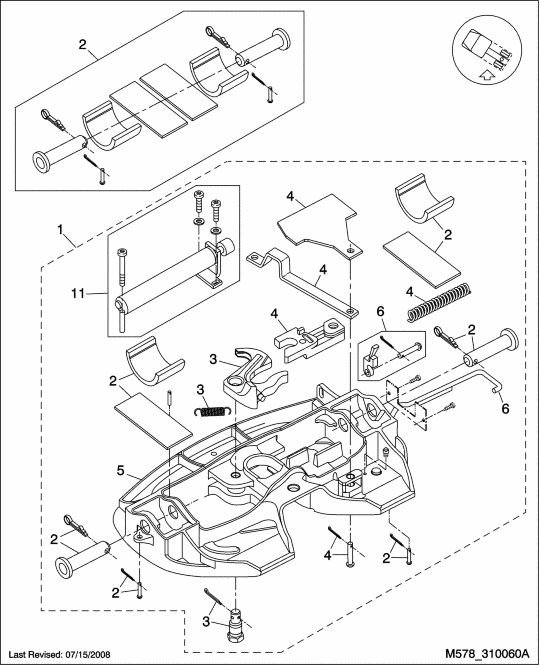

  6. thaistick
    thaistick Road Train Member
    1,416
    1,737
    Dec 7, 2014
    OTR/Thailand
    I have a Simplex also, the jaws were worn and had a lot of slop in it and the pin was adjusted to the max. I ended up buying a new unit for about $900 bucks.
    Here's a diagram, sorry a little late.
    Tombstone69 and 25(2)+2 Thank this.
