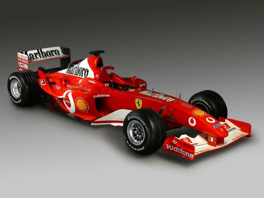

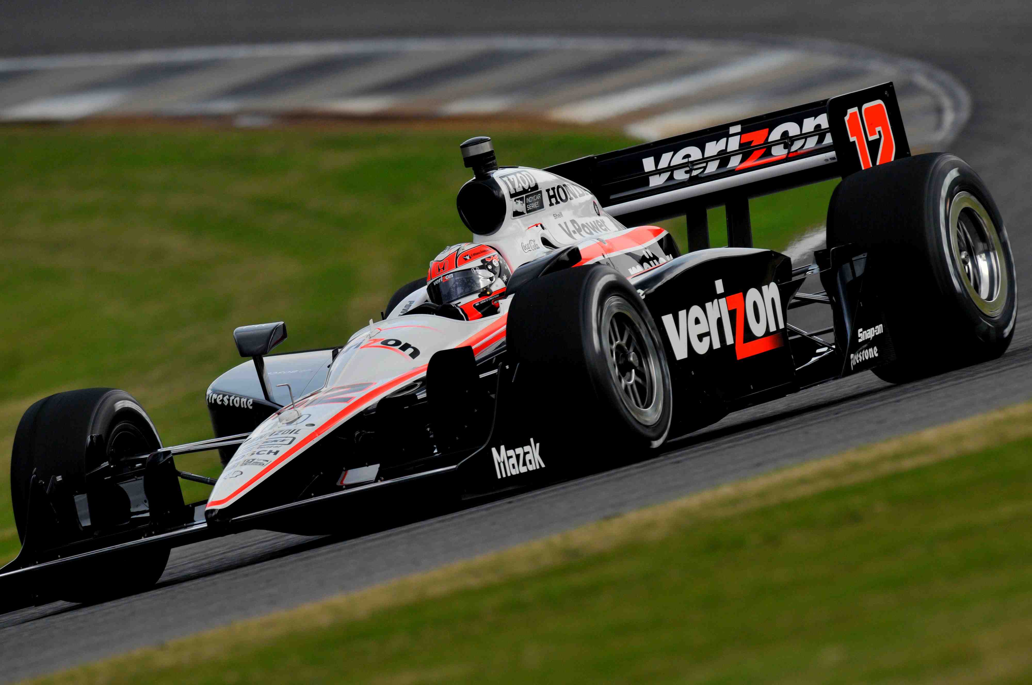

    Trust me being in the NASCAR capital of the world and been to few races myself, those guys would ditch that cowling intake in heart beat for a ram air effect from the front end. The cold air box cowling intake is really a restriction that the rules has made everybody use for years. Notice the top fuel, funny car drag racers use ram air along with Indy Car and Formula one use ram air that if a cowling induction was superior they would be doing it doing to their rules are more liberal in car design.
