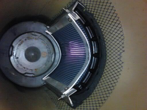

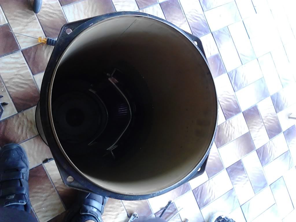

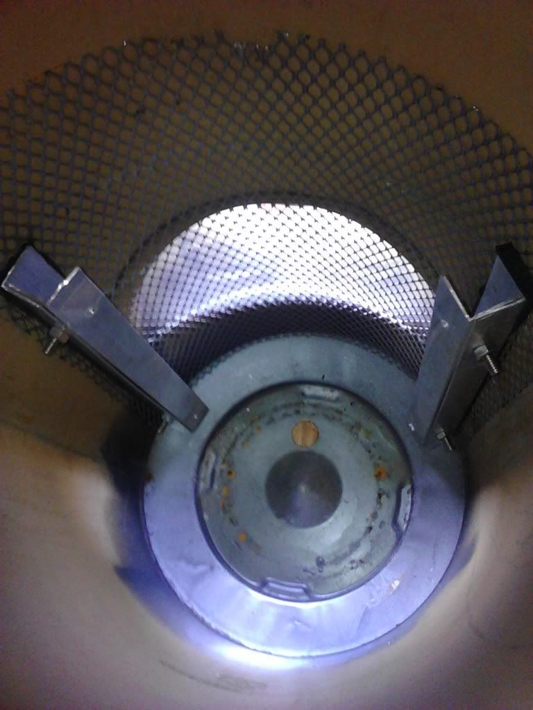

    time for some pics both air cleaner housing have been modified to accept the new panel type filter,brackets and netting installed as well. i used some simple aluminum stock 1/8 thick x 1" x 1" angle some screws and 1" x1/4" thick alum flatbar to keep air filter from bowing in if it happens to do so.
    all i have to do is pull chrome top cover off housing reach in slide out and wash as i need to ever so often and walla...i wasnt going to pay $$$$ for a commercial type k&n washgable filter lol.

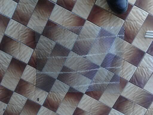

    this is the mesh i used its basically the same mesh used on the outside of the stock air filter a little recycling going on here lol

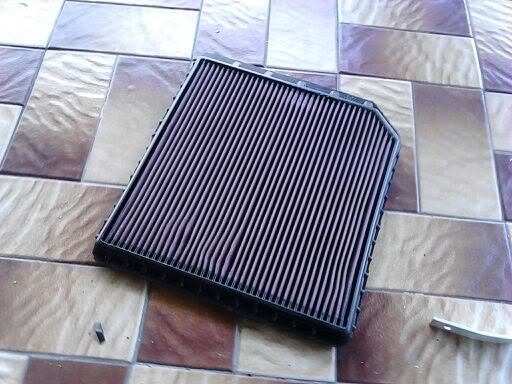

    heres the new filter trimmed to fit a little its 1" thick by 12"x12" p/n 33=2456 these will work on the 11" diameter housings.

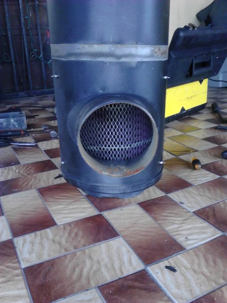

    and a finished look thru the suction hole on the air cleaner housing
