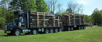

    I was thinking "Dump and a Pup" as we have a lot here in CA as well as A/B dumps. But I guess a "pup" is just a trailer towed behind any straight truck after looking it up.
