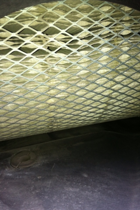

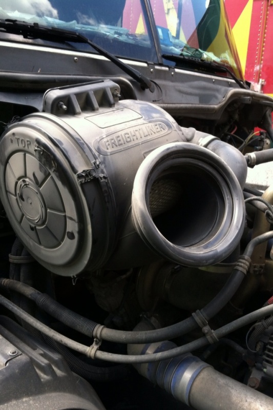

    Is this the filter you guys are talking about?

  11. peterd
    peterd Medium Load Member
    349
    365
    Jan 7, 2012
    St.Catharines ON
    No.The DPF is in the exhaust system under the cab.
