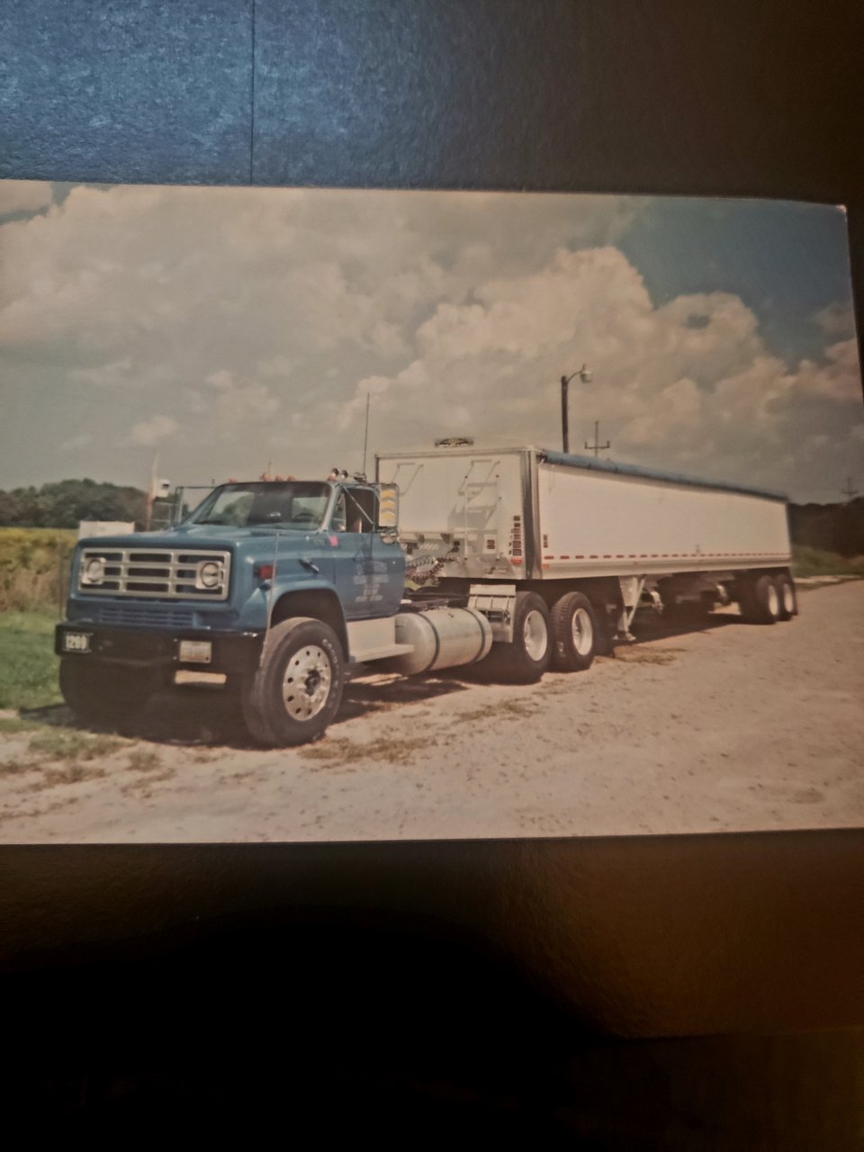

    They made heavy duty gassers with air systems? That's something you don't see any more.
