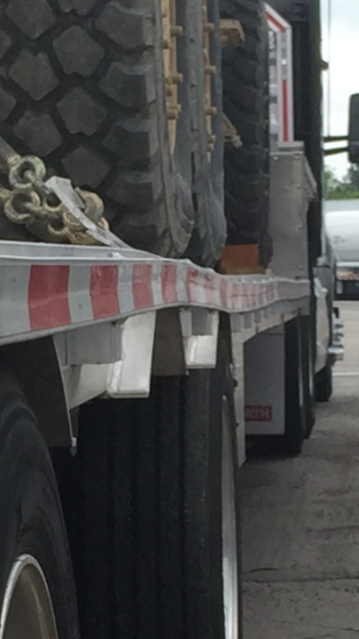

    Someone posted this a while ago....

    It takes a really big dozer to be over 8'6" wide at the tracks. An LGP maybe, I'm not sure I understand the to much of an incline part.
