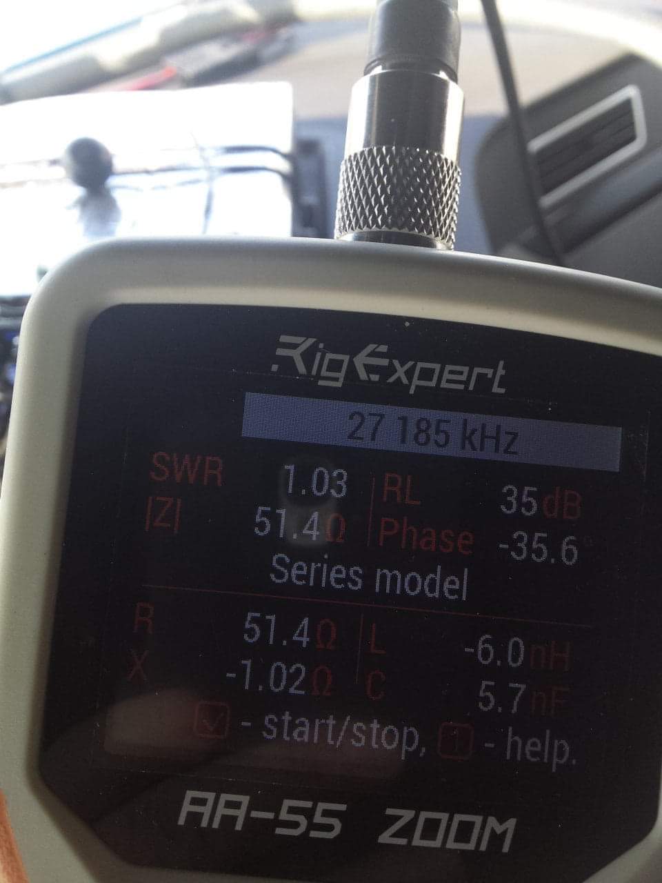

  6. craig_sez
    craig_sez Road Train Member
    5,570
    2,714
    Sep 5, 2013
    novascotia,Canada
    It can be done..If a fella like me who knows sweet frig all compared to most can get this close,then its very possible..
