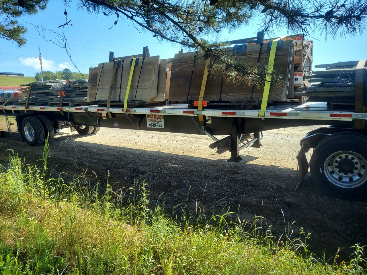

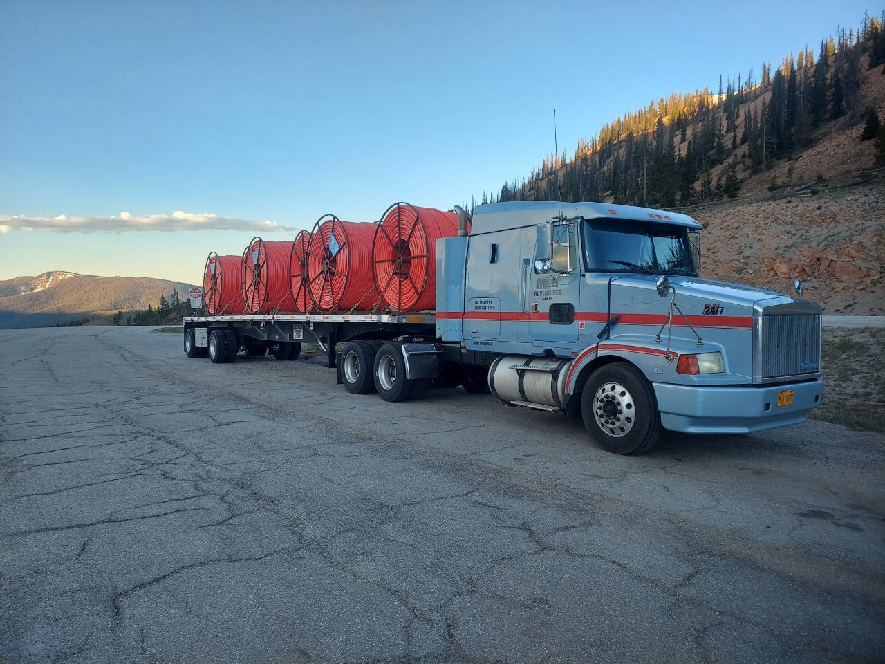

    20210603_095643.jpg 20210605_062052.jpg 20210605_062030.jpg I've got an update on an old 11.1 DDEC II. Bought this truck of a Nebraska farm. 11.1 DDEC II 350 HP.
    Brought it home and did lots of work, including injectors, overhead, adjust fuel pressure, and much non engine work. Stock injectors BTW.
    I had never pulled a trailer more than 3 or 4 miles, but when I picked up a rental in Springfield, MO and brought it back near Fort Smith, I knew I had to do something. Even empty, I was dropping 3 gears (13) to get up small hills.
    Sent the ECM to Pittsburgh Power while I was working on the suspension. Got it back and noticed a difference bobtail.
    Hooked to my trailer Thursday morning for my first ever load and loaded 48k of stone. Got back up to 40 near the 270 in OK.
    Set the cruise at 72 and didn't shift till I got off at Elk City.
    Took that load to Taos, NM, by way of Raton, through Cimarron to Eagles Nest, Angel Fire, and up and back down to Taos. Picked up another load yesterday and took over Monarch Pass.
    Not sure how much it's putting to the ground, but it's impressive, and a bit worrisome. Otherwise no issues with the tune other than my pyrometer quit, so I'm unsure of EGT's.
    Sitting in Montrose now waiting unload Monday, then pick up 48k of sticks in Dolores. I'll be headed over Wolf Creek, La Veta, and Raton Pass Monday so I'll update how it's still doing.
