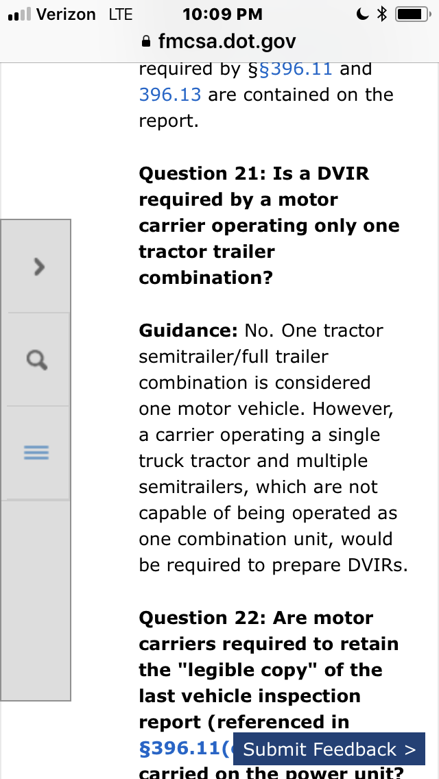

  8. Rideandrepair

  9. Rideandrepair

    Like I said I have no desire to argue with any DOT or you for that matter. But I think I’ll stick with the 4 DOT certified opinions I’ve already gotten. I was just as surprised as any would be when I first read it. I too have read a lot of the refs and as anyone knows it all boils down to final rule and interpretation

    No, because that's exactly what I said. All that's exempt is the DVIR.
    There is no logging exemption!
    If you do the pre/post you must log it! I dunno how clearer I can get on that.
    I think you are confusing two different things....
    Do you have to pre/post/dvir?
    Do you have to log it?
    You basically have to pretrip to get the required "satisfied" requirement. No single truck exemption here
    You do not have to post trip inspect a truck.
    As a single truck operation, you do not have to do a DVIR.
    In either case, if it's required to do or not, IF you do it, it MUST be logged.

    I understand your point and agree you are correct. The only time I’ve had to fill out a dvir is when I worked local 23 yrs ago.Also once while doing Power Only for a retailer. The last Company I was Leased to for one year in 2003 had been warned on an audit. They had 100 O/O and every trailer pulled Sometimes 3 a day had to have a dvir on file at Carrier. Even though Trailers-stayed at DC. and were owned and maintained by retailer.It made no sense. They were Overwhelmed constantly keeping track of the reports. Otherwise Since doing OTR I have never done a dvir. Showing a 15 min pre trip became Standard along with 15 min to open doors at consignee etc. as a result of Companies being audited and advised. Pre trip simply shows you satisfied the requirement for inspection. I personally was taught to always do it as a way of covering your own . And also to avoid a possible log book ticket or even to show that a burned out light was operating when you started out or even worse if some defect caused an accident to avoid being held liable. I wish I hadn’t asked the question during my audit honestly. Because once I got the answer I had to do it that way in case of another audit. Since I had been advised and the key word being compliance. Which brings Me back to the only reason I care is to avoid a ticket or an audit violation/ fine or a roadside inspector from H###. I agree the only clear exemption is for actual dvir. I knew the original comment would stir up a response. I thought I had a clear understanding because of my prior info. Having gone over the regs last night even though I was very tired. I see that you Sir are absolutely Correct.It shows how even the interpretations of the Law enforcers aren’t always correct. Reminds Me of how I once beat a log book ticket based on the eception for prior day current day etc being allowed to catch up.etc. The Judge agreed with me after reading a copy of the reg I brought.Later after re-reading regs I realized the exception only refers to OOS meaning I Still was guilty of not current. Lol . Thanks
