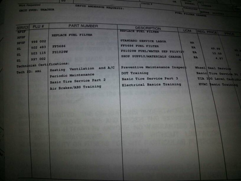

    Not an exaggeration at all. I'm going home in 11 days, I'll let them know. Sunday evening the petro replaced both fuel filters,
