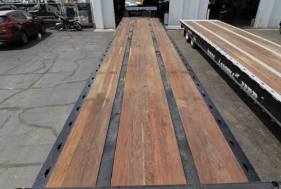

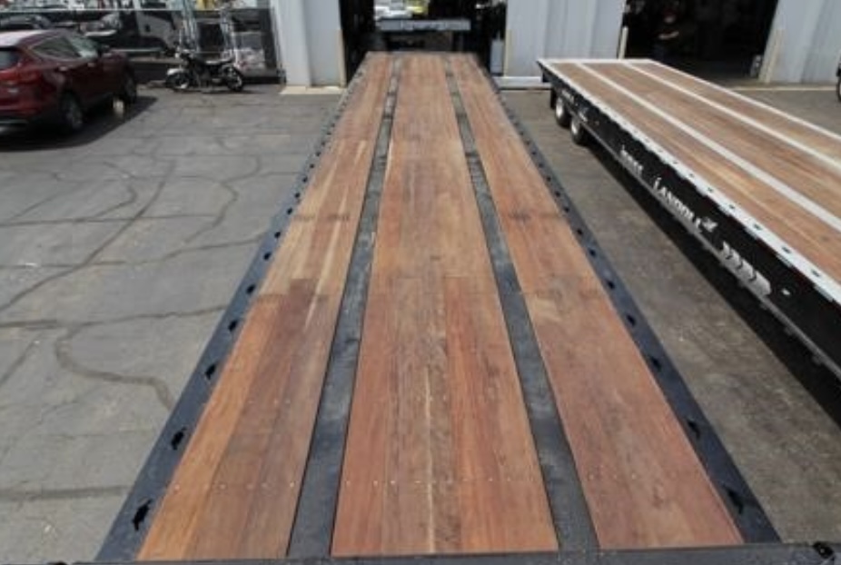

    Couple questions…
    How does this work where there are slots for chains instead of hooks?
    Second… What type of weights or trailer would require you to have three rear axles on your truck? Will a standard tandem axle handle pretty much anything you could do with a 35 ton or even 50 ton RGN?

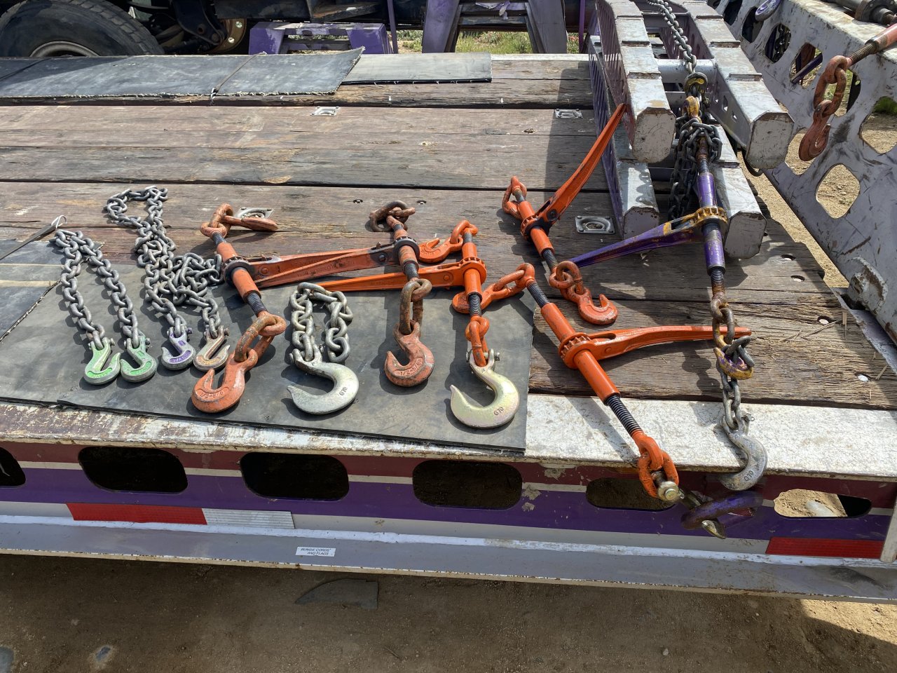

    F37A234A-C196-42AD-B222-B0E486953BA3.jpeg this is some of my stuff
    red hooks are 3’ one with one hook
    purple hooks are 6’ with one hook
    green hooks are 3’ with 2 hooks
    yellow hooks are 10’ with 2 hooks
    and i have added slip hooks to 2 binders makes it easy to tie down in a smaller footprint and can go right to D ring or machine 2 less chains to move

    Yes, you can attach with just a chain in the holes along the side of the trailer, and then have a hook on the other end to attach to the equipment. The small slots at either end of those holes will catch a chain link similar to a grab hook.
    So, with a 35 ton trailer it has the capacity to haul 35 tons. Obviously this will put you way over legal on axles and you will be running on a permit. Many states sell an annual permit that allows up to a certain amount of weight per tandems, tridems, etc. Often it is much less expensive to have a three axle trailer than a two axle trailer to haul the same amount of weight due to less expensive permits.
    Essentially, from what I gather you would like to use the trailer for, I would think a two axle trailer would suffice, but it might be worth learning the permit costs if you intend to haul more than say a 200 class excavator (50,000 lbs. ish). The lighter the trailer, the more you can haul without a permit.
    I can give you an example of what Idaho does in regard to the annual permit and subsequent cost per mile of various loads if you like, but you can probably access your states permit system and get a feel for how it works - may be completely different than Idaho. Wyoming is quite different for example, but I can essentially permit most anything in Wyoming that I can in Idaho, I just have to get a clearance and by a single trip permit each time.
    I think it boils down to what your immediate needs are, and what you anticipate playing with in the future.
