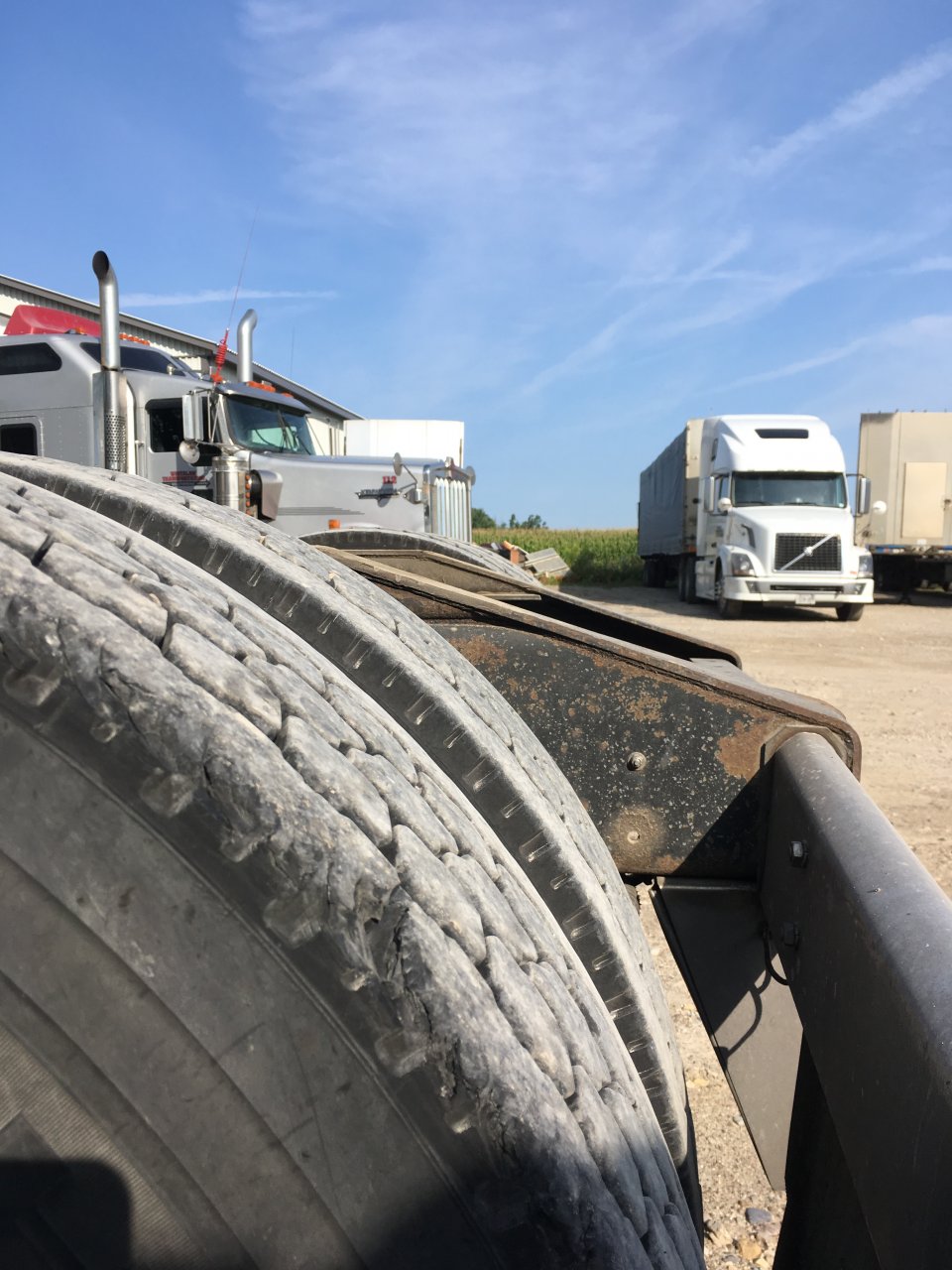

  6. DDlighttruck
    DDlighttruck Road Train Member
    1,386
    19,918
    Dec 12, 2015
    My tires are actually taller than my ramps. The tires rub too, it's pissing me off.
    I can't get that GD thing to slide. I was 11,900 steers and 34,620 drives 1/2 tanks.
    cke, Oxbow and noluck Thank this.
