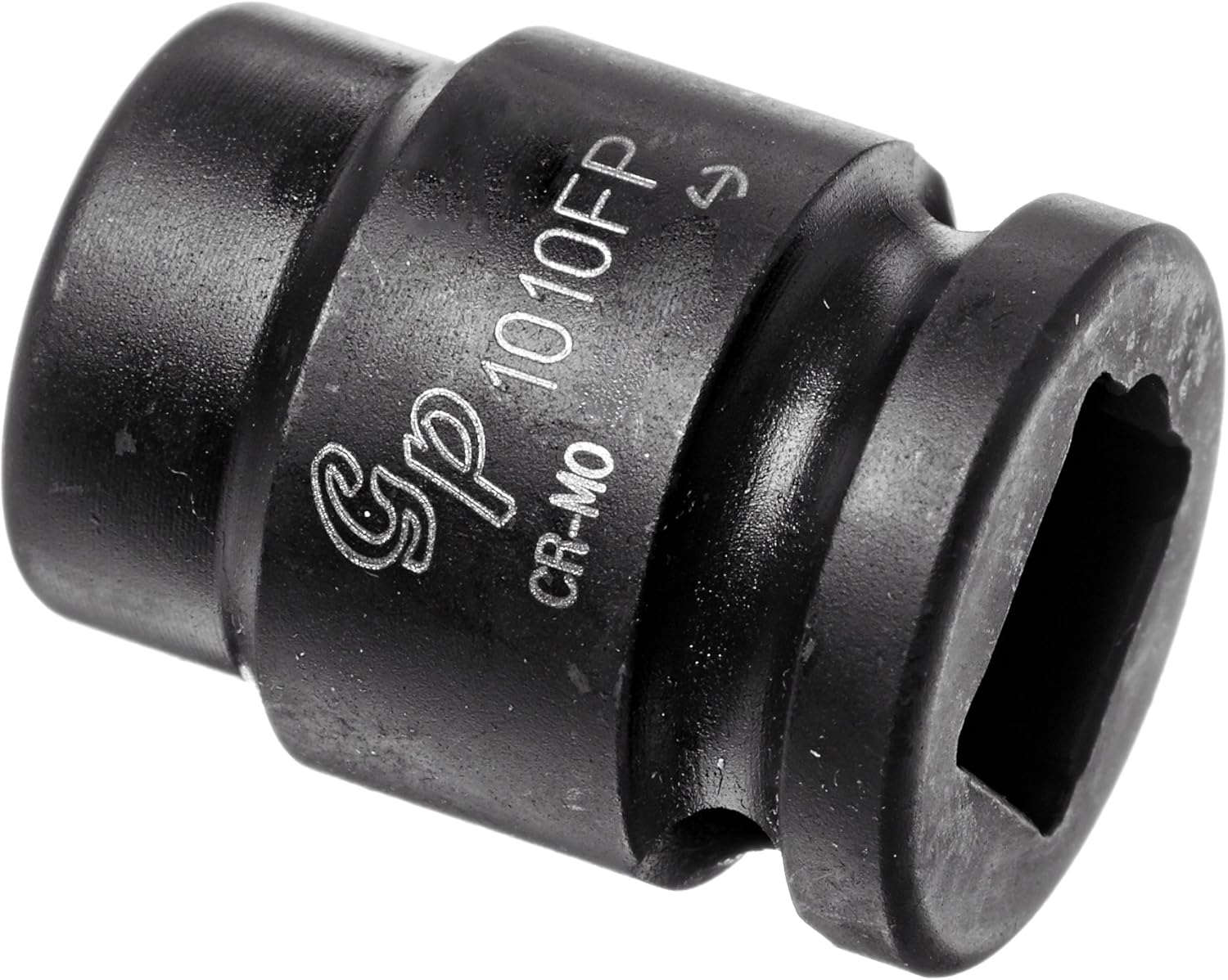

    And by the way it's not a 7/16" on the slack. It's 5/16" You need to move the safety spring up then you can adjust them. I use a small screwdriver then this tool on a ratchet. You can pick one up at Napa or on Chinazon.
