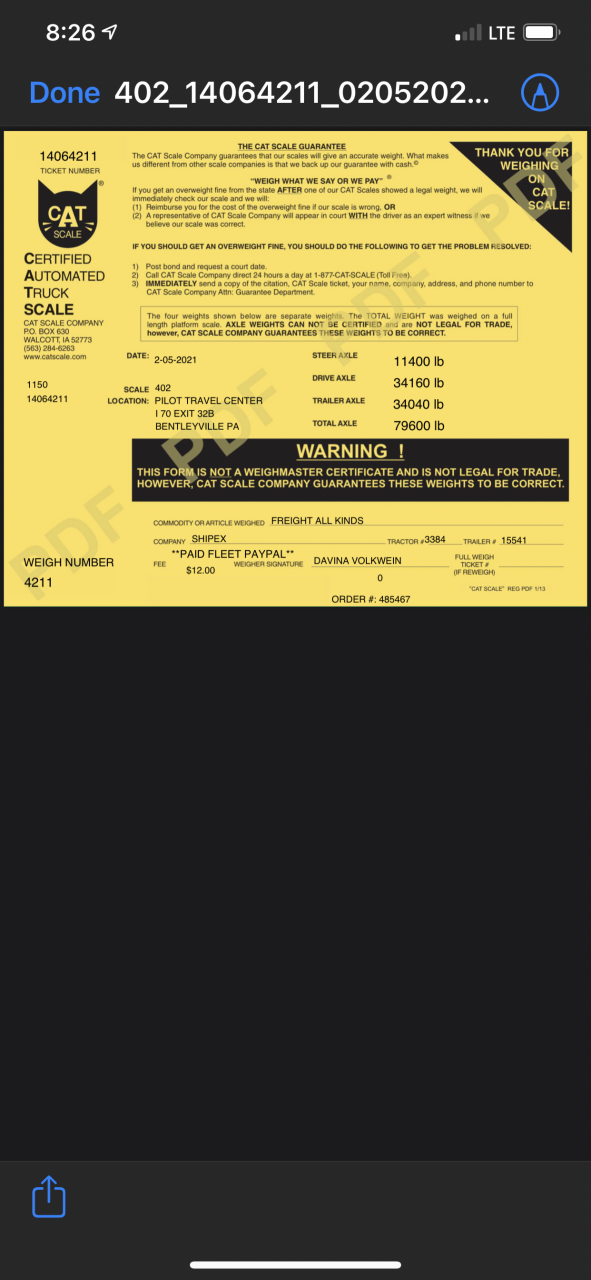

    In my 2020 Cascadia, Empty reefer I get 26psi in my drives. Max legal weight is about 62psi I get a good idea of where to adjust my axles based on that. Mind you, you have to be level and in neutral with brakes released. If the suspension is torqued up, the indicated psi will be off, sometimes substantially. Same goes with getting weighed. Be sure to roll on gently, and put the truck in neutral with brakes released before getting weights. Just enough foot brake to keep from rolling.
    sliding axles isn’t difficult, and sometimes you just do the best you can. I had a load not too long ago it was just barely under gross, but I couldn’t get the weights perfect. Not off enough to worry about, so rollin. 4F64FEC6-FD63-4B37-8BB0-F5743183282E.png

    OK. So the air bags are adjusted to inflate to a manufacture recommended height. For your trailer, 26 psi is the set inflation for the trailer when it's empty. Am I correct, so far? Then, once the trailer is loaded to 34,000 lbs, your reading on the trailer suspension gauge would be 62 psi. This would tell you that you've got a heavy load and that you would need to get weighed. The BOL mentions the weight, right? BUT if the BOL says 20,000 and your suspension gauge reads 61 psi, you'd know there's something wrong, right?
