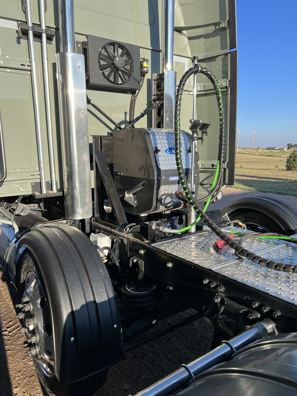

    E9D4873A-F36A-4608-A88A-BC335286AA12.jpeg How I primed my carrierpro apu, I had to relocate my unit from the frame side to the catwalk, as in behind the sleeper between the framerails. When I disconnected my fuel lines it lost prime. After relocating it and reconnecting all the wiring and fuel lines it would not start. Tried starting through 9 cycles. Nothing.
    I got out my weed spray bottle with a hand pump, put fuel in it, Hooked it to my fuel supply line and opened the air bleed bolt on the apu then pumped fuel into the system, closed the bleeder, reconnected the supply line to the fuel tank. The motor started on first cycle, sputtered a bit
    And then ran fine.
