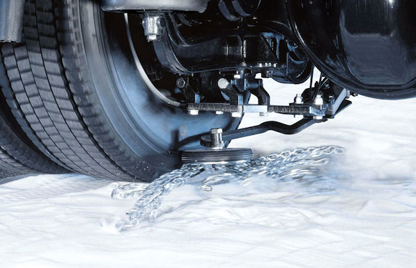

    Chains for trucks with full fenders...
    Isafarmboy and Roberts450 Thank this.

    Usually you see those on school buses and emergency rigs.
