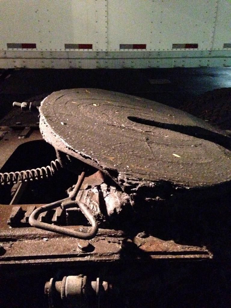

    Theres a release arm on the side of the 5th wheel as seen in this picture. Once you ease the pressure on the locking jaws by backing up against the trailer, you pull on this release arm.
    OPUS 7 and Badmon Thank this.
