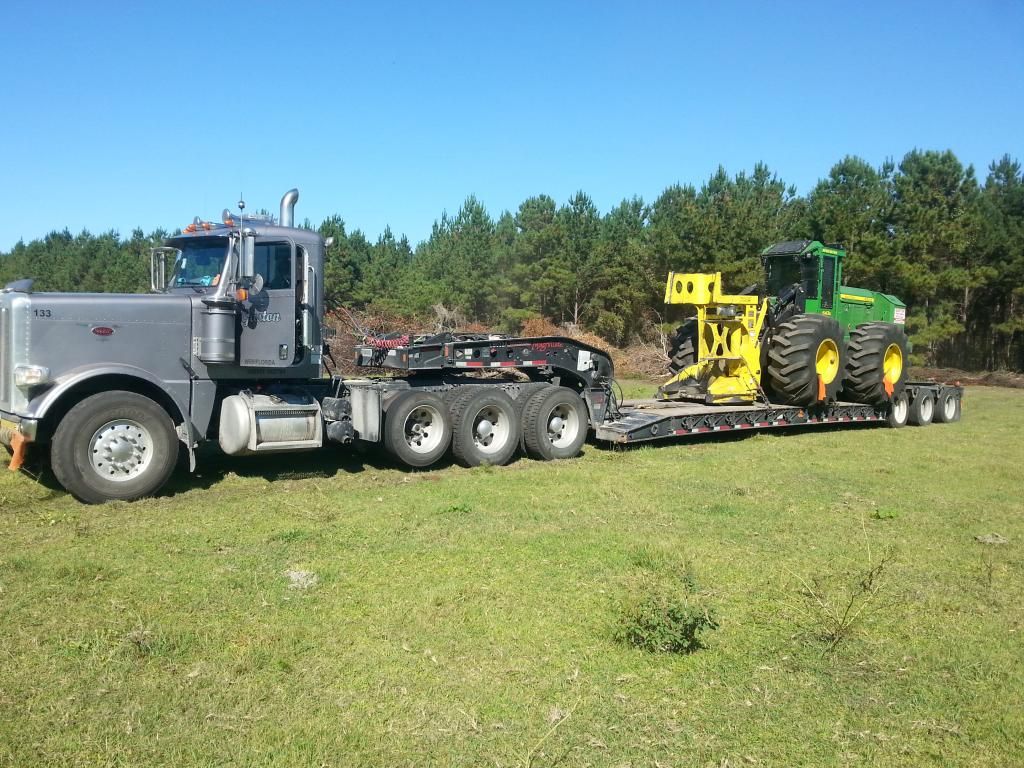

    Riiiiiiight. So according to your logic, my RGN trailer that I haul loads grossing up to 160,000 lbs with, and is only 6"-8" from the ground to the trailer bottom, shouldn't even make it out of the yard without "hitting something"? What about all those parking lots (car haulers) you see every day even lower than that? I guess they must "hit stuff" constantly. Wow. I guess I must have dreamt that 80k miles that were put on my odometer last year. Go figure.
    OP- Crank them up as high as you can (while you're at it, try squirting some grease in them; it's amazing what that stuff does....lol). I would say try to get them at least 10"-12" off the ground if possible. Then, just watch where you drive (ie- avoid potholes, deep humps in road, steep railroad crossings, etc.)
    Be safe out there driver..... And get your shop/company to fix them landing gears ASAP!
