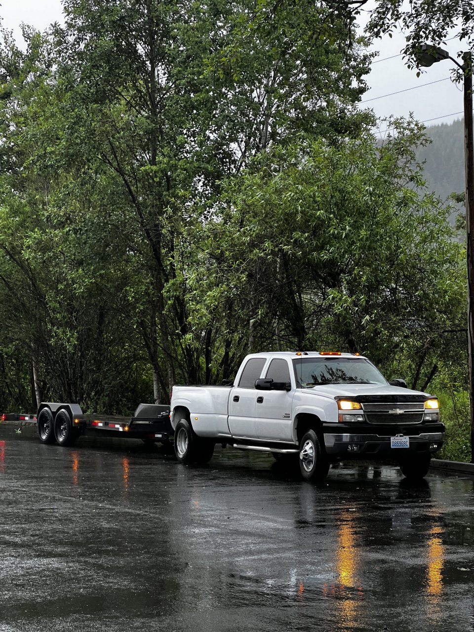

    • I’m 18 years old :wave: No CDL
    • 2005 Chevy 3500 DRW LLY diesel 4x
    • 2023 full tilt deck car trailer, 14k#, 84” wide and 18’ deck with 3’ dovetail
    Here’s a little background on me. 18 years old, I currently have a 05 Chevy dually and a 21’ total deck. I use this setup for retrieving my old trucks and tractors. I usally get these rigs going, and sell, or part them out on Facebook and EBay. I do pretty good for being 18, and in my last year of High School. But when I’m out of school I want to step into something that makes me more $$$. Looking into transport work. I’d like to work for myself rather than for someone else. More freedom and such.

    1 - you need a cdl if that trailer is 14k and be careful what you load on it, you only have 9k capacity before being overweight.
    2 - the trailer is limiting you, a three car trailer may be better.
    3 - extend your oil changes, 4/5k is too soon, that engine is designed for 10 to 15k oil changes. Also blowby is ONLY measured by being on a dyno and run under a full load.
    4 - better get insurance quotes now. It isn’t what you are paying now,
    5 - speaking of your truck, if it is a 4x4, get a two wheel drive truck.

    I'm impressed with you at this point and think you have good potential, but I see a couple of potential problems.
    Someone can correct me but I think it was the 2005 LBZ had a huge problem with over heating. But no doubt it was the 2005 Duramax. There was also some issues with turbo issues. I'm not sure about the LLY but I thought it came out in '06. I welcome any corrections . That Alison was a beast in my opinion.
    If I remember right, that '05 Chevy 3500 was rated at 12,500. Your trailer is 14,000..... Thats 26,500. That requires a CDL... a class A since it has a moveable hitch.
    The fact that you are mechanically able, is a huge plus and at 18 yo, I applaud you for that & is a huge plus if you decide to do this.
    Its been a long time since I had any dealing with that truck and I am going strictly off my memory and I didn't do any research prior to posting so again, I well any correction.
    Good luck young man.

    Thanks for the info. I’ll look at the card in my truck and see what its rating is. Overall is 26k. But need to subtract the weight of the truck and all that.
    Yes that’s the 2005 that has all the over heating problems. LLY 04.5-05. A lot of it is because the cooling stack, dirt gets trapped in the radiator cooling fins and really restricts flow. I removed my radiator and cleaned it. Runs cool now. Another big problem is the factory turbo inlet and intake. I put a bigger turbo inlet to let more air in, a S&B cold air intake, and deleted the EGR and catalytic converter. So it runs and stays cool real good now.
    thanks for the replies, I figured I new my answer about the license and trailer. Both are too small :(

    No... you don't subtract anything.. GCVWR is what it is on the sticker(s). Thats gross weight right down to your shoe laces. If its on the scale, is counted toward the GVWR & The GCVWR.
    GCVWR = Gross Combination Vehicle Weight Rating.
    That includes vehicle, trailer cargo, dirt, chicken lights, tools, straps, etc.... Just like Prego... If it's in there, its counted as part of the gross weight limit. Whatever it weighs on the scale, is what is counted toward the gross weight. It cant weigh more than the weight on the sticker/specs etc.
    FYI, the GCVWR is different from the GVWR.
    GVWR is just the truck and what it weighs gross with cargo (it cant weigh more than that on the scales). This does not include the trailer .
    When you connect a trailer, then it becomes a combination vehicle. GCVWR.
    Its two different weights.
    For example in your case.
    Truck GVWR is 12,500
    Trailer GVWR is 14,000
    Added together is the GCVWR = 26,500.
    You cant weigh more than that when you pull on the scales.
    Your truck cant weigh more than 12,500
    and your trailer cant weigh more than 14,000, and
    your gross weight cant be more than 26,500
    on the scale....

    Grumppy correct me if I am wrong, but does that trailer look like it is too light duty to be used for commercal use?

    I'm not sure that its too light duty for commercial use by any rule, but I mean, it's just not big enough to serve for any useful payday. One full size, maybe two small cars is all you're gonna get on it. That's just not going to be feasible in my opinion. You're gonna have to hunt & peck to find those one - two car loads and that usually aint gonna pay much in my opinion. You need to be able to move 3 or 4 cars to be able to even get basic work. That is if you're just gonna run cars. But even if you're moving general freight... a common carrier.... 14' aint really gonna get you any steady freight, commercially. I mean, its just not something I would entertain. You need to get up in the 30, 35, 40 ft, and 20k - 22k flat in my opinion for general freight with a hot shot. You need to be able to haul at least 4 cars to get into car hauling specifically to interest me.
    My opinion is general. Occasionally, someone can find a diamond in a river. In other words, there's always a chance someone could stumble up on a jewel of a contract for a 14' 14K trailer for commercial.
    That's the problem in this industry with new entrants, they get an idea & they assume just anything will work. They wanna go in business, then find a market. You gotta find the market, then buy your equipment based on your market. You can't haul ice cream on a flatbed. You cant hauls cars one or two at a time. There's just no reasonable market for that.... generally speaking. JMHO...

    Yes that’s what I was thinking too. I couldn’t imagine I’d have a big market with such a small trailer. 21’ isn’t big enough. Well guys thanks for your info! I’d say my questions are answered. My truck is useable, but my trailer is too small for hotshot. I’ll probably just buy or build a 35-40 footer and look into possibly into getting CDL. I just wouldn’t be able to drive interstate. Washington sucks. Wouldn’t be able to take this up until I’m 21. I’m gonna keep doing research on my options, and what cargo I’d want to specialize in
