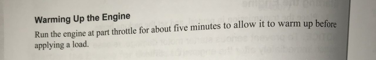

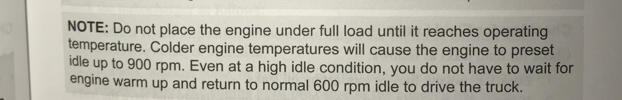

  7. PE_T
    PE_T Road Train Member
    Well, I’m confused. Can someone decifer these two instructions? They seem to contradict one another. It’s from a Detroit engine manual for the DD15 & DD16.

  10. LoneRanger
    LoneRanger Road Train Member
    3,687
    9,584
    Jun 3, 2018
    It’s interesting as this truck i think high idles around 800. Turn cruise on and engage.
