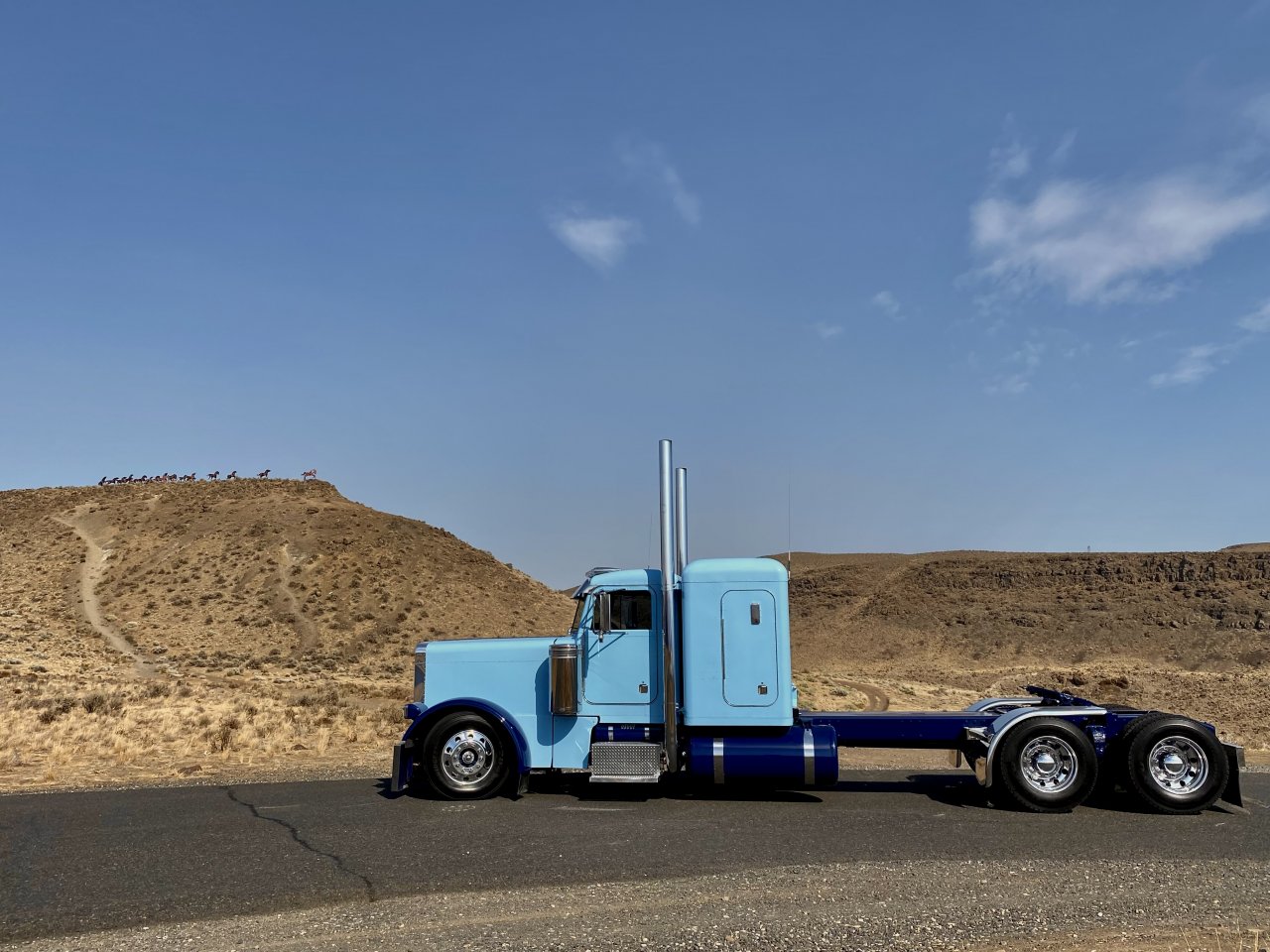

    This truck sat for almost 7 years. When I picked it up in Tacoma it still had fuel in it from nearly 8 years ago that the guy bought in Kansas on his way home with the truck. I drove it back with no issues and it’s hauling fuel in NE now with the same fuel filters. I imagine these days with bio fuel that the results may be different.
