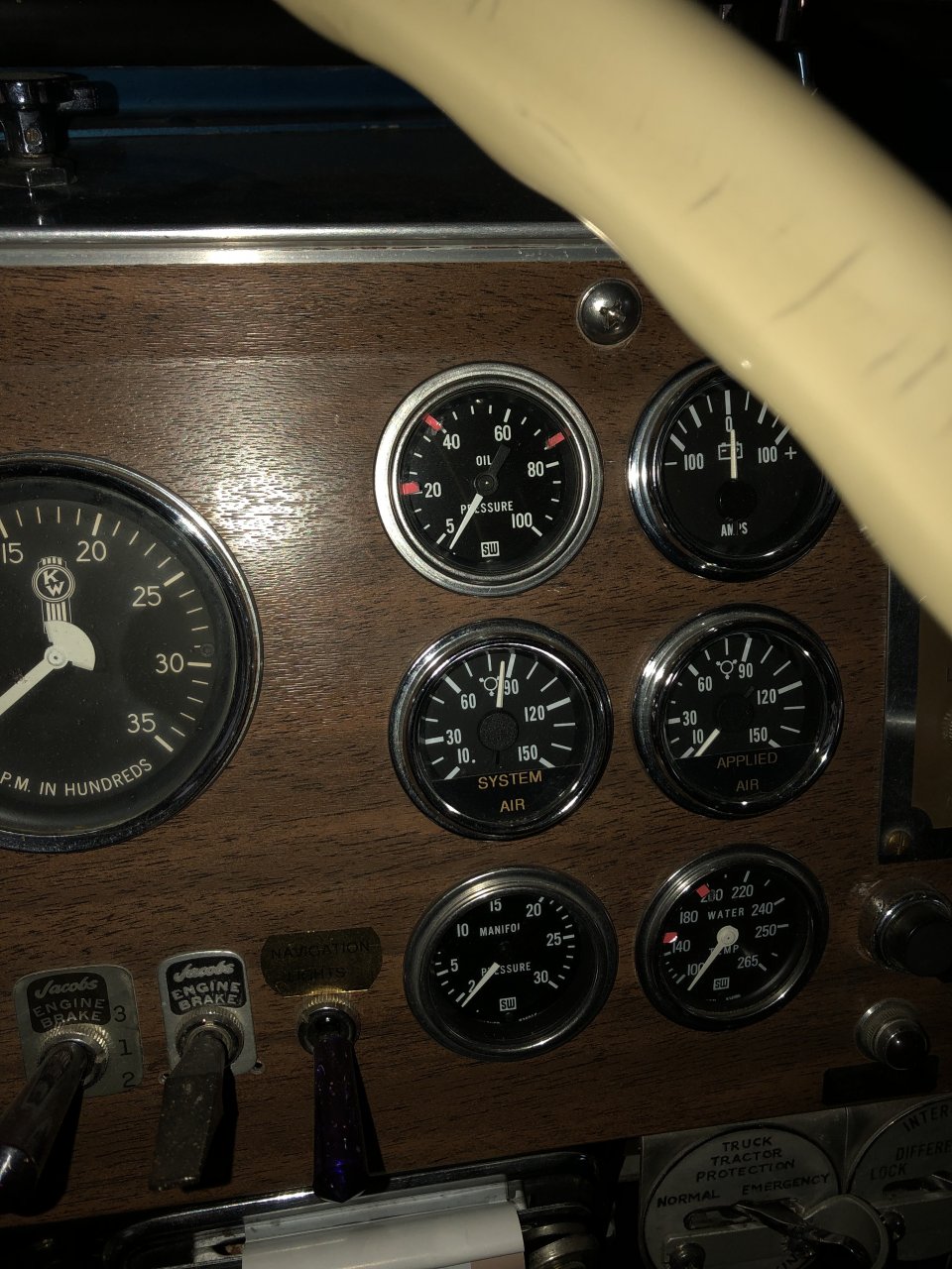

    Parked in the garage last Friday afternoon. always let the compressor run till dryer purge before shutdown.
    Just got up in it to check it out to run it tomorrow morning. 9F1EF385-6A3A-43D8-8098-CD89D9733CD1.jpeg
    no plastic lines in this thing. All aeroquip/ stratoflex.

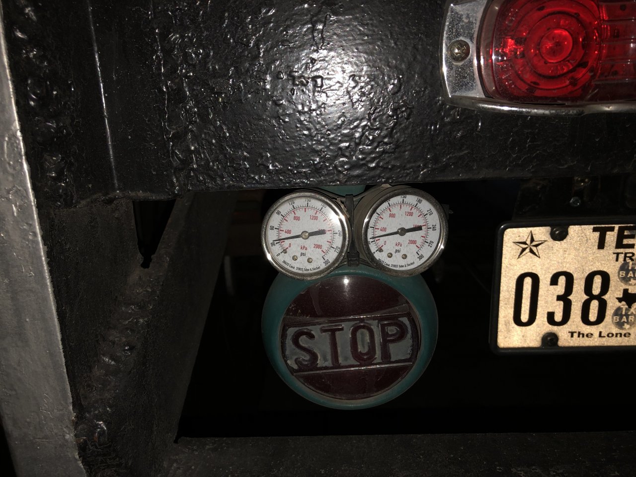

    1950 Fruehauf trailer doesn't have spring brakes and still holds air for months. Left gauge is system air from “red” supply line and right is “blue” service side. The sealco safety valve keeps 30 psi applied when park valve is set to the 30 cans to lock brakes like the 30/30’s with springs do and keeps about another 30 psi in the tank. This trailer is all original 1/2” copper hard line.
