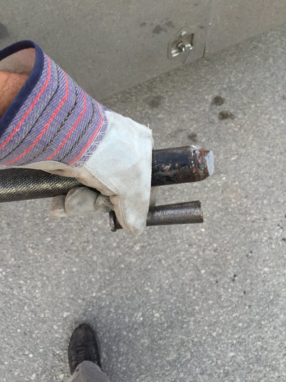

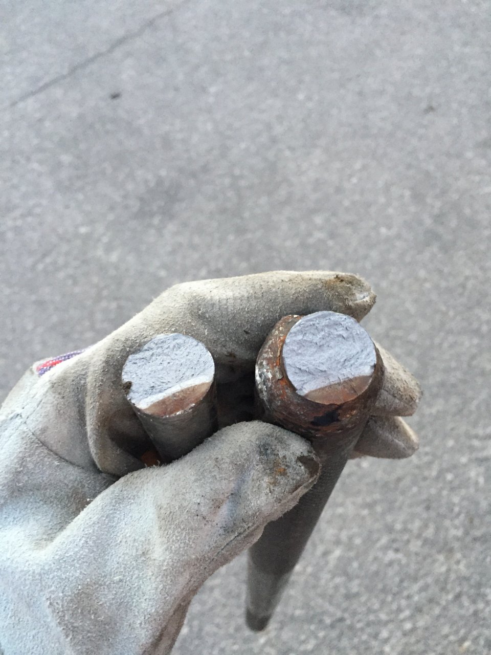

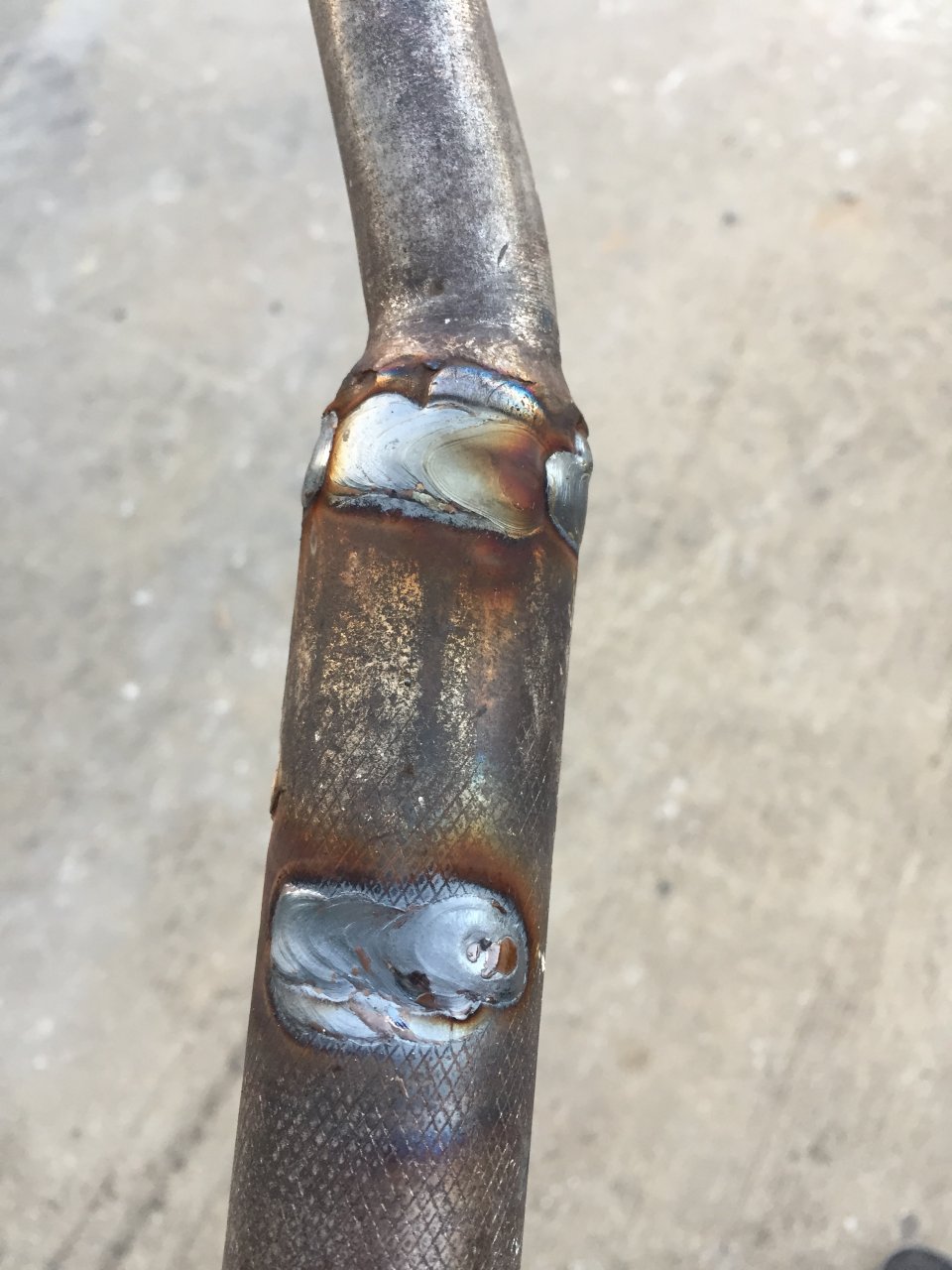

    I got this bar when my original broke. Didn’t have it even a year and it broke like this. Talk about just about hurting myself badly…
    No warning, just BANG!
    I tell my boys, always keep your feet under you, and your head clear off everything when you’re winching down. Saved my bacon, because I ended up on my hands and knees.
    After breaking the el cheapo bar, and welding my original bar once, I did this. It held for a little over a year until it started cracking above the welds.
    I gave up at that point and bought an Ergo bar. A little over two years on it at this point.

    That guy's been cracked for a bit before it let go.
    cke and Diesel Dave Thank this.

    Yes, after it broke the preliminary crack was evident.
