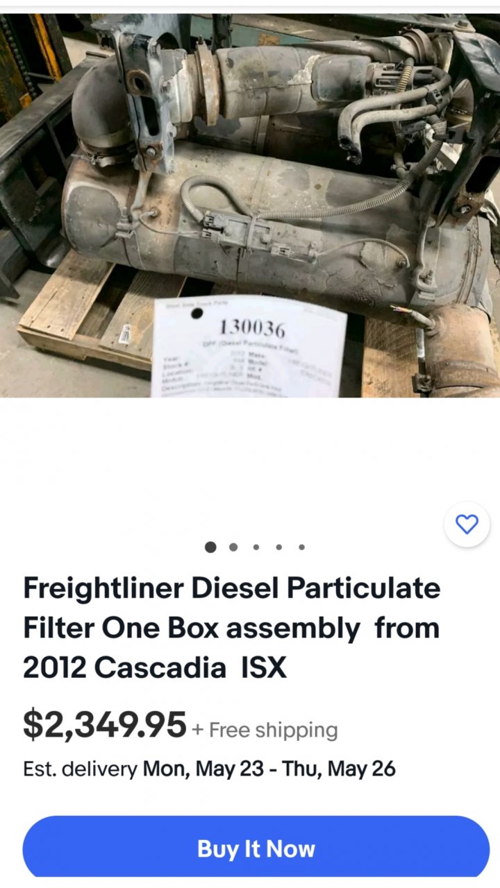

    Cummins isn't the same as Detroit. That's actually an SCR.
    Had Casper done at 675K. $8700 at Cummins.
    And it's all got to be recalibrated with the ecm or it will never work right.

  7. Flat Earth Trucker
    4,240
    16,037
    Nov 19, 2018
    I don't know that as I am no diesel mechanic. I was just happy to find a one box on Ebay. Now maybe I'll find a two box.
