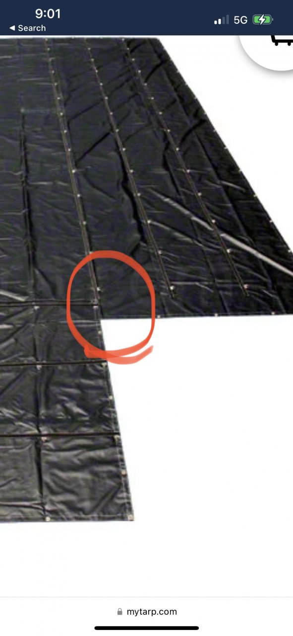

    Yes. I’d inquire about how much setback there is in this upper seam, for wrapover flaps. That doesn’t look like very much. 12” would be my minimum. 18” would be better. You need that overlap, so water isn’t blowing straight in behind your end drops and soaking your lumber, drywall, etc. With these guys making them to order, they’ll probably do just about whatever you want.
