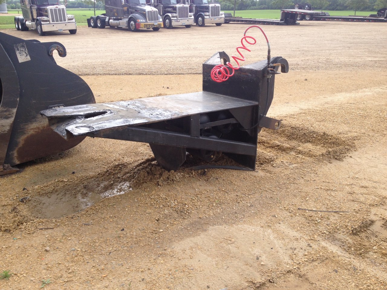

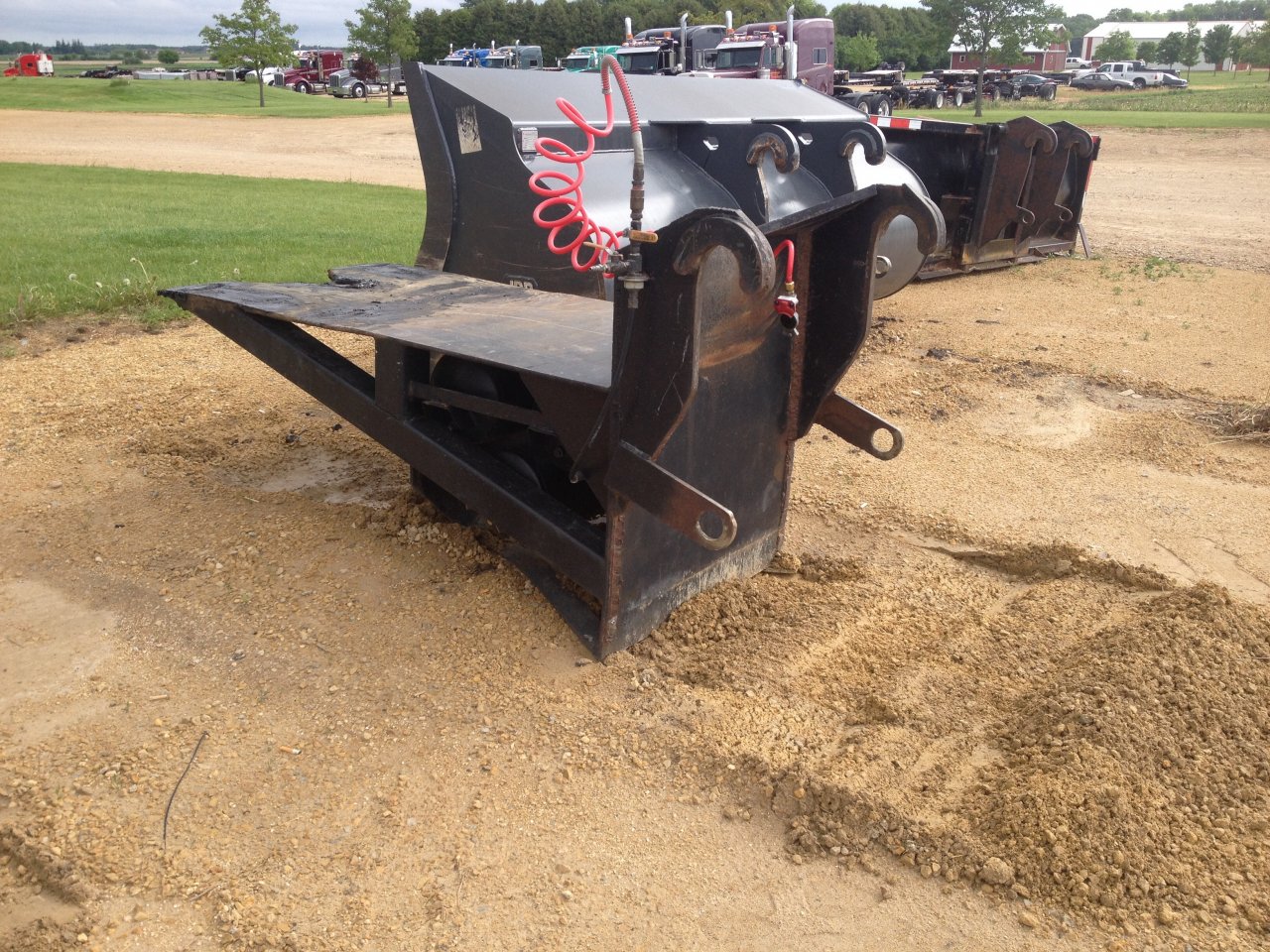

    Took me a while to find this thread. At my companies yard currently and remembered you had made this thread, this is what they use to move our trailers around with a John Deere 644k wheel loader. Don't know if you ever made anything but figured would share pictures anyway

  6. x1Heavy
    x1Heavy Road Train Member
    34,017
    42,135
    Mar 5, 2016
    White County, Arkansas
    A ten gallon tank is not gonna cut it.
    You are looking at 70 pounds PSI going into 4 brake chambers that have springs inside of them capable of locking the wheels. You want a tank as big or bigger than the one on the trailer at the tandems. 120 is ideal.
    Winter time, you have the additional problem of icing. Once in a while a ball peen hammer making ding ding music on the wheel drums rather than the thuk thuk of frozen pads tell you that wheel released. Chock your tractor first.
    Maxi bolts is the proper term, these things are about several inches long by very thick. It's going to be about a one inch nut driving it in. You would have to do it by hand because a impact is too short. Need 4 of them for the two axles of your trailer.
    It's probably way better to whistle up a jockey down the street, he can scoot and grab that trailer. Or any bobtail can do it. You can probably buy a junker bobtail out of a rust yard for a few thousand or less. It might be a air start but it will work.

  7. KenworthGuyNH
    KenworthGuyNH Road Train Member
    1,050
    2,686
    Dec 11, 2011
    Central, NH
    That's a clever fabrication; I dig it!!

  11. Caterpillar Cowboy
    Caterpillar Cowboy Heavy Load Member
    837
    607
    Nov 11, 2010
    Wyoming
    I got the Snap On one, Can't remember what it cost me but I don't remember it being like some of the times where I need to be sitting down. I don't mind getting odds and ends like that at full price, my dealer has seriously hooked me up with some barely used tools that sure make it come out in the end.
    That attachment for your loader looks like the absolute cat's meow.
