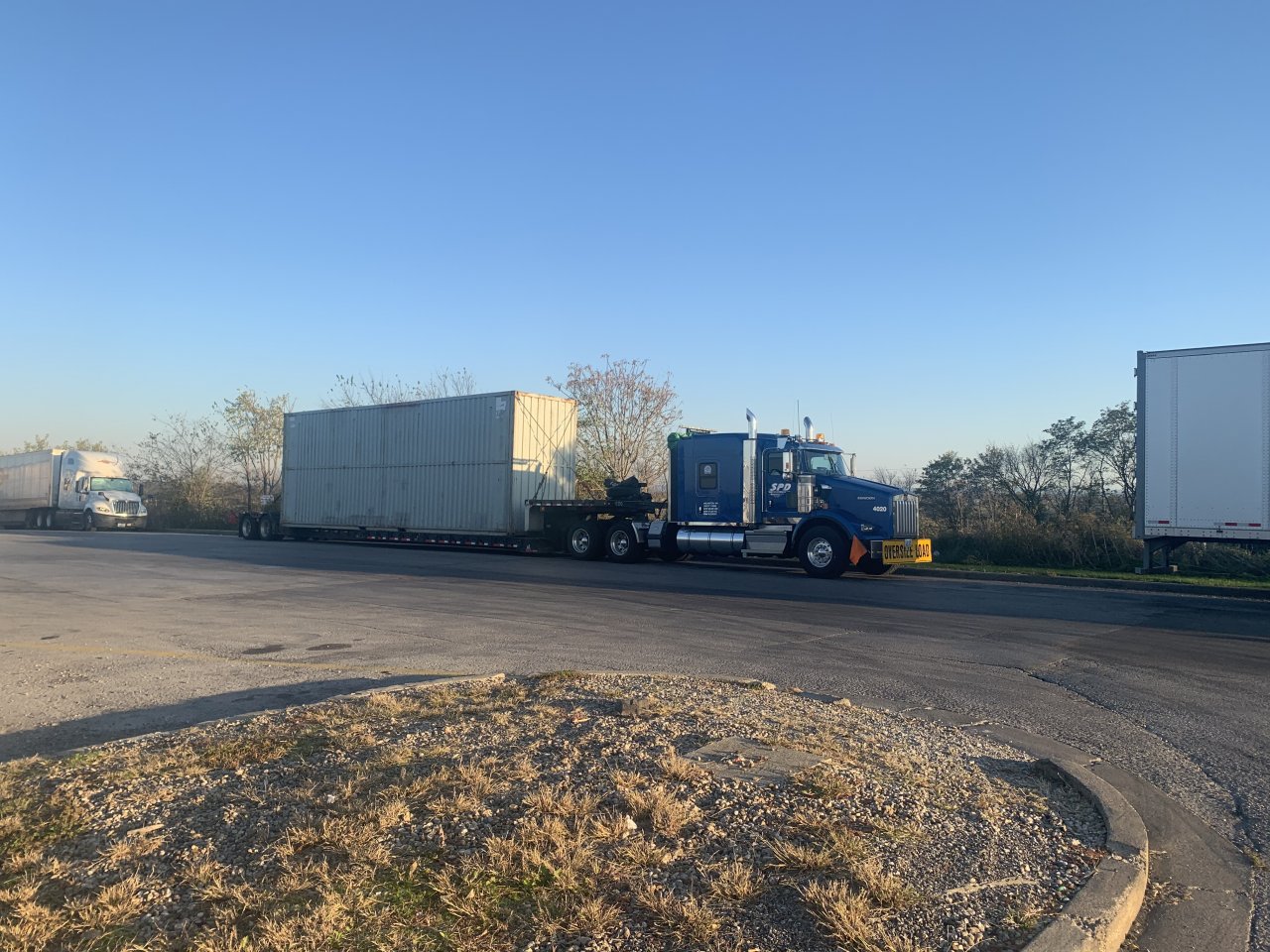

    What’s the advantage of using a pool chassis? Is the rail preloading pool chassis so yo can drop and hook? It seems like if you had company owned chassis you’d want to use this instead.
    just curious because I don’t know how that side of the business is, the only containers I haul would be “a bit” over height on a regular chassis. A1070C47-9370-4700-9B12-A060D29D98D8.jpeg
