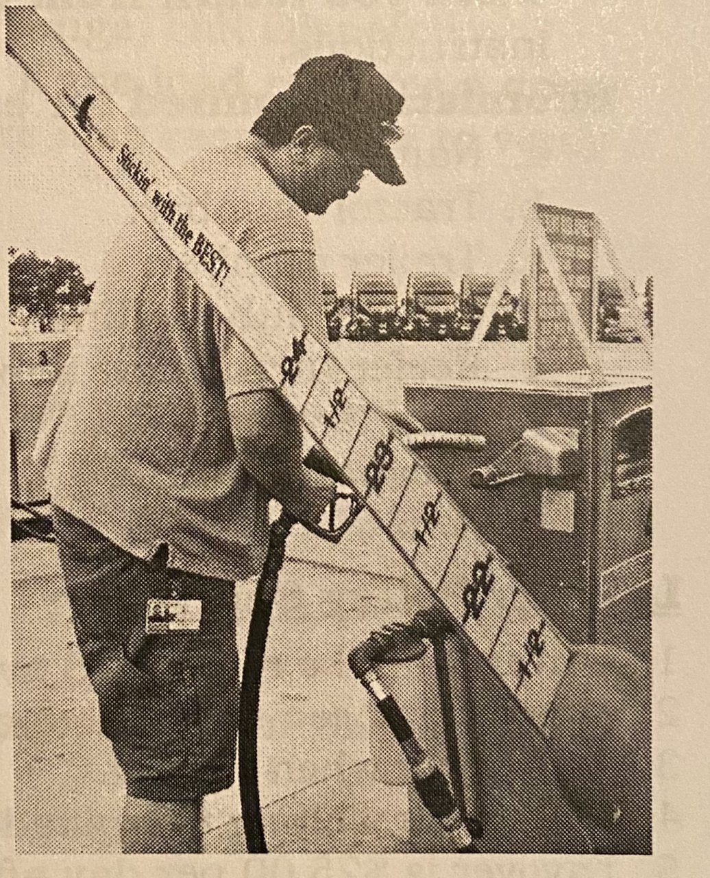

    This is the fuel tank chart I was talking about. It’s from a Stevens Transport’s manual and probably only applies to cylinder shape fuel tanks. You also need a fuel stick to use the chart. It also helps if your tank cap is behind the truck cab so you can easily slide in a fuel stick to measure how many useable gallons you have left.

    Check out my comment #36. The chart I posted can give you a rough idea of how many usable gallons you have left. So in the case of the OP, he can stop the truck once his low fuel light comes on, and use a fuel measuring stick to determine how much farther he can go. The chart compensates for unusable fuel sitting in the bottom of the tank.
