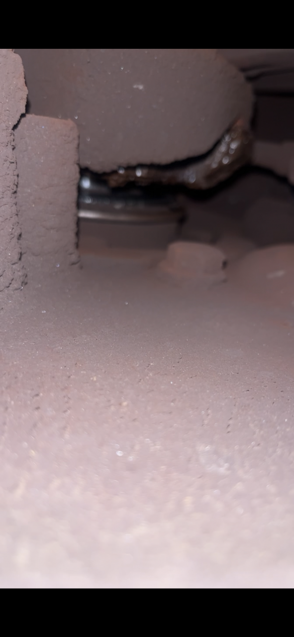

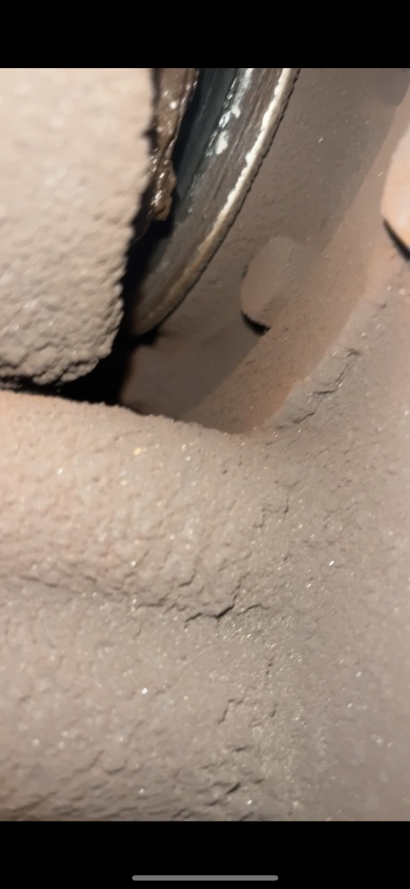

    Truck is in the shop for clutch to be looked at. Clutch pedal was stiffer than stiff yesterday and parked it over night and this morning wasn’t near as stiff. Hydraulic clutch. Fluid level full. Shop said clutch just needed adjustment. I had taken cover off to look in it. Has a lot of shaving in there atleast to me.

    Second thought, some light shavings you say ?, stiff, probably clutch springs coming apart. I’m not to familiar with those hydraulic set ups. See what the shop tells you.

    I had one with mechanical linkage in a 388. Hard to push one time. Have to shut off or jam it in gear the next time. Kind of load the engine when stopped at a traffic light in gear sometimes. Then work great for days at a time. It had pieces of broken springs in the housing. Unusual it was.
    With the metal sparkles in his pics I wonder if he has springs rubbing on flywheel bolts or a busted clutch hub.
