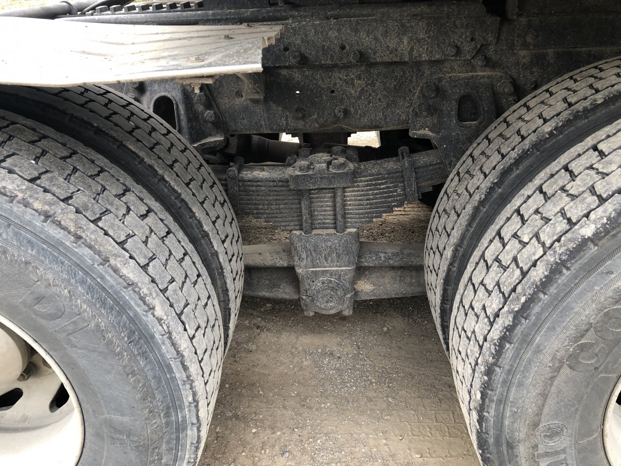

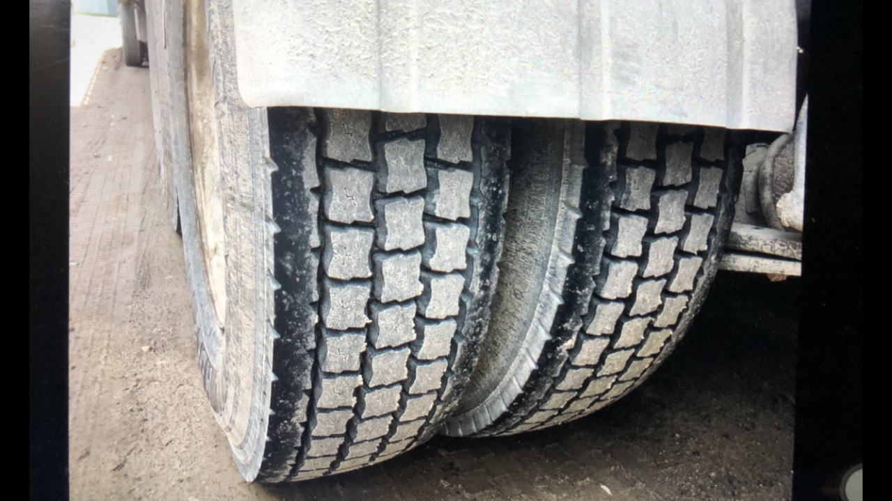

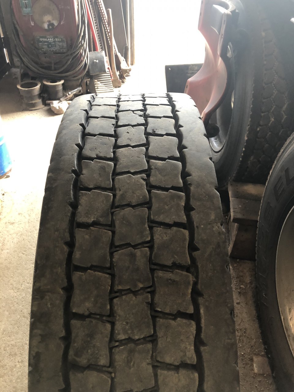

    I currently have my steers at 105 and 90 for the drives.
    The picture below is 105 psi. I didn’t like that. So aired down to 90 psi which fixed that.
    I’m still on this set of tires so far.
    2CABB6A1-548B-4651-B2EB-56274A75B518.png 254BC7F3-9CE1-4924-8E9D-465DA28A5F57.jpeg B896C72E-4879-463F-A3BB-3A5E322EFC9C.jpeg 3C771F7A-44DF-422E-AB5C-527A06AAA323.jpeg
    The live bottom and end dumps I have them at 105. The lift axle is 120.
    I have been thinking of increasing the pressures from 105 max to 110 or so for these trailers as they’re always heavy. The tread is wearing more at the outside instead of near flat across which is telling me they need more air.

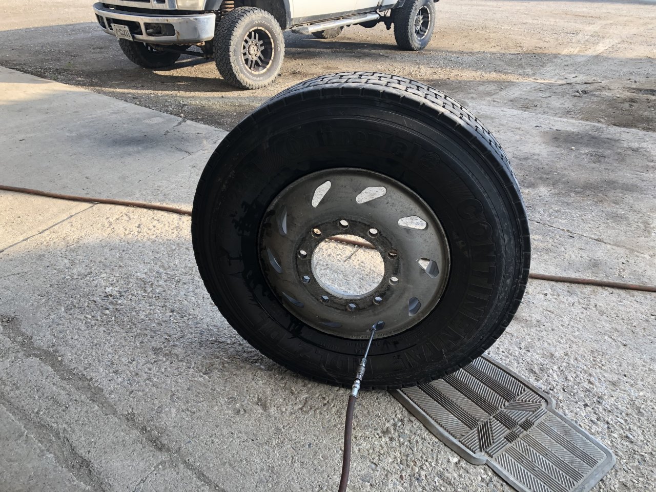

    Where did you get that air chuck? The only ones I can find that lock on are the little ones that lock on at a 90 degree angle, and it's almost impossible to use with Alcoa's.
