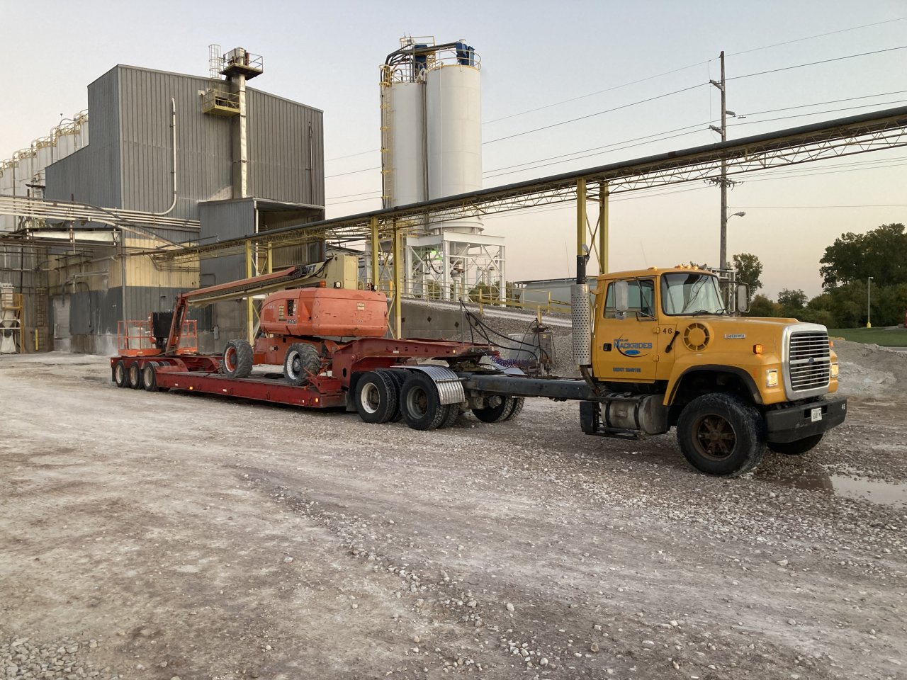

  9. W923
    W923 Road Train Member
    1,332
    4,061
    Feb 28, 2022
    I’m sure it could happen but never heard of it and never had one look at my doorpost to see what it says. I deliberately try to have 45-50k on the drives which in my case are 46k axles and assuming they don’t know by looking they’re not worried about it ( if I made any sense here)
    To answer the op
    I can permit 120k on an annual permit in Illinois with 6 axles with no questions asked. I got 150 ish a couple times on 7 but rarely do anything that big.
    so with a 120k permit I can do 79500 on the deck with this setup IMG_4207.jpeg
