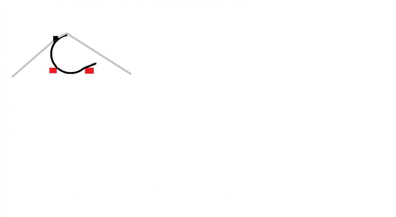

    I would nail a 4X4 under the tooth/cutting edge after rocking them back then a second behind them. The crossed chains should not go through any bushed pin holes but should cross between the attachment points. A 2X4 can be nailed on each side if you want some extra security.

    Thanks! I'll add some 2x4s to keep them from rocking and I've got the chains through the attachment points, through the tops.
    Everything seemed so sensible when the equipment has little spots to add a chain!
    Take away the actual equipment being hauled and I realized I had a lot to learn!
