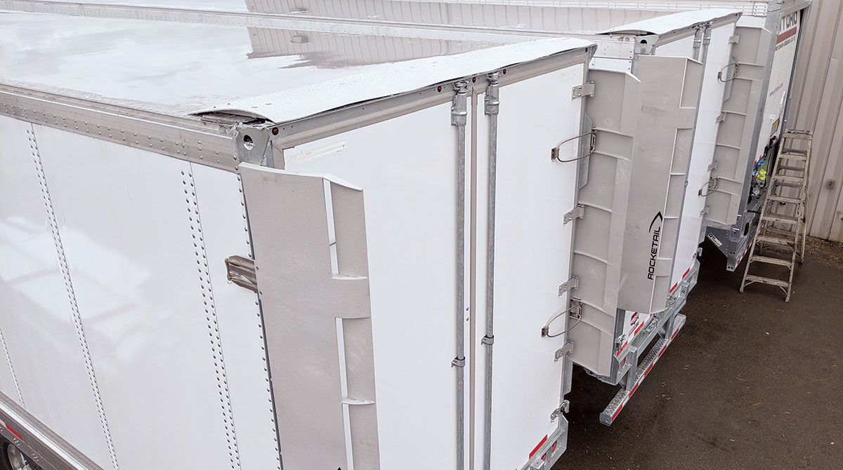

    Like these thingamajigs.? Can't say I've ever seen them, but also never been west of las Vegas..
    Rocketail brand

  11. Dave_in_AZ
    49,840
    315,843
    Not that big. These are real small.
