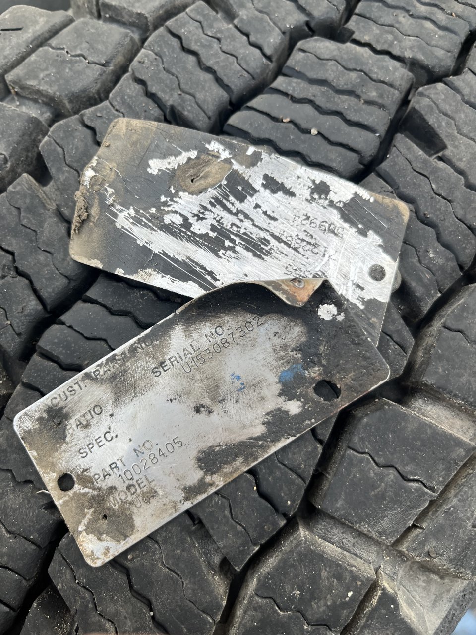

    Hello, purchased a glider truck on auction, and I’m trying to find the build specs , what rear ratio I have. Called Fitzgerald , and they said it’s not their truck . Who else builds Freightliner with Detroit 12.7? Thanks!

    Should be a tag on the rears with the gear ratio.

    Call Freightliner with the vin. They can tell you who ordered it.
    You can get close by jacking up the rear end and count the driveshaft revolutions.

    Literally anyone could have built it. Billy Bob could have ordered one and built it in his backyard. Best bet is call FL with the VIN and they could probably supply you with the build sheet outlining what they sent it out the door with. Not all gliders are rolling gliders either, some were ship from factory with no engine, transmission or axles.
    Not knowing the history who knows if the rears are even still what it was originally assembled with?

    The tag was not helpful at all, serial number , and model number , but the model is a crap number, no one know what it is. The ration was empty,
