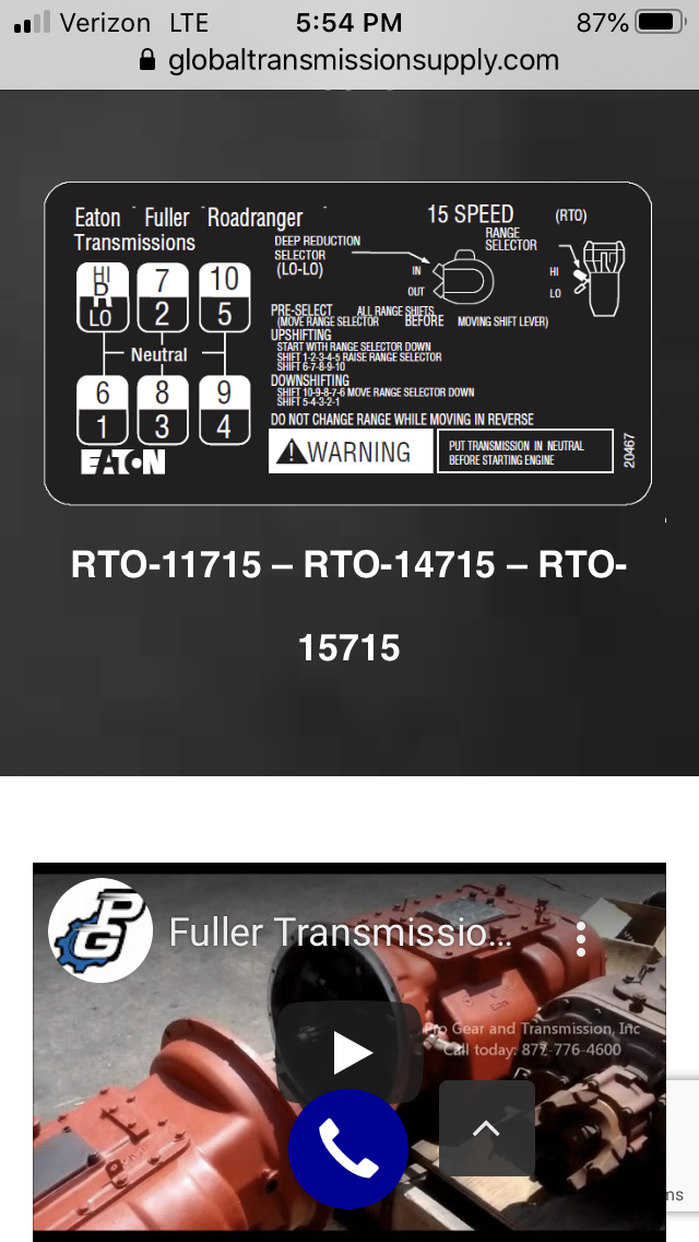

    935802AF-0C3D-4A51-94EA-3151A966E1A5.png 75720EB6-4837-416E-BCD1-0CE1A86A73F4.png Assuming I have 1 of these in this truck?

    Tags on old transmissions can lye as people have changed things internally.
    If it is that 15 speed you should be able to be in low low behind reverse. Shift 1, 2, 3 and split to low. Then shift straight back up next to the gear by reverse. Then continue on with the pattern. Some other guys break the pattern a few gears higher. Either way I thank you only get 11 gears in progression.
    So why is it a 15 speed? I guess all those other numbers were used up?
    In high range if the splitter causes the truck to go faster when shifted it is an OD back box. That is the only way to have a double OD along with a OD front box.
    mile marker 27 and haycarter Thank this.
  7. jamespmack
    19,998
    215,914
    That is Single overdrive trans. U shape patter is solely in top cover. That used to be standard, and H pattern is a optional. All in top cover.
    BoxCarKidd and mile marker 27 Thank this.

    It will not split, when in high range. Only functional in low range, which is what makes it, 3 layers of 5(15). So, you answered my question, as to where the OD is; transmission. Thanks.
