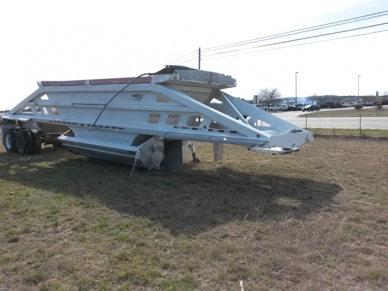

    Ok Lowjack, I'll try uploading the picture again. If you can see the picture there is nothing above it to "hoist" it up. Also, this pic was taken BEFORE the gates opened and it sank. It just shows you where its parked but not all that helpful for getting advice. Its out in Burnet, Tx by the way...
    There is a front end loader nearby and trying to get the guy who owns it to help me out..

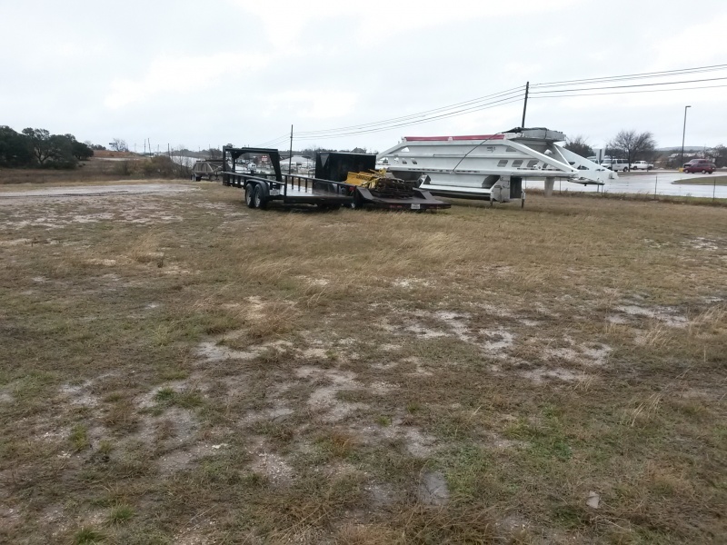

    Ok, here is a better pic

    I get it now, so the thing was dropped with the hoppers open. I couldn't visualize the landing gear connected to the doors. Looks like kind of a funky set up. I'd think you could get the frame of the tractor under the plate, unless your tractor has squared off ends. Years ago, trucks had that angle on the back of the frame just for that reason. I suppose you could dig hole where the truck wheels would fall into, but that might bring up a whole new set of problems. The front end loader looks like your best bet.

    if you get the front end loader, reread my earlier post , having looked at the photo, it looks like hooking a chain from corner to corner then lifting from the center with a second chain hooked to the front loader set on the side of the trailer you should be able to back under the trailer... if the gates are forced open with air pressure you may want to air up the system so that they don't try to close while lifting and tare up the landing legs.. just my two cents...
