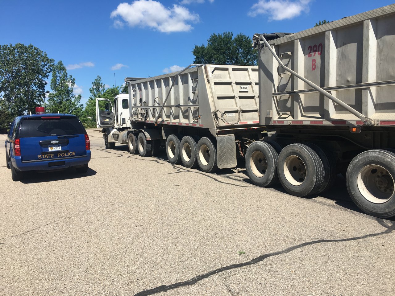

    772C4CD5-B553-485A-BE37-DBC1C5E62240.jpeg To make it more interesting what if he was in one of these? It pretty much tracks like a pickup with a small trailer. I will turn from any lane and I don’t worry about clipping a curb or another 4 wheeler

    And here we go
