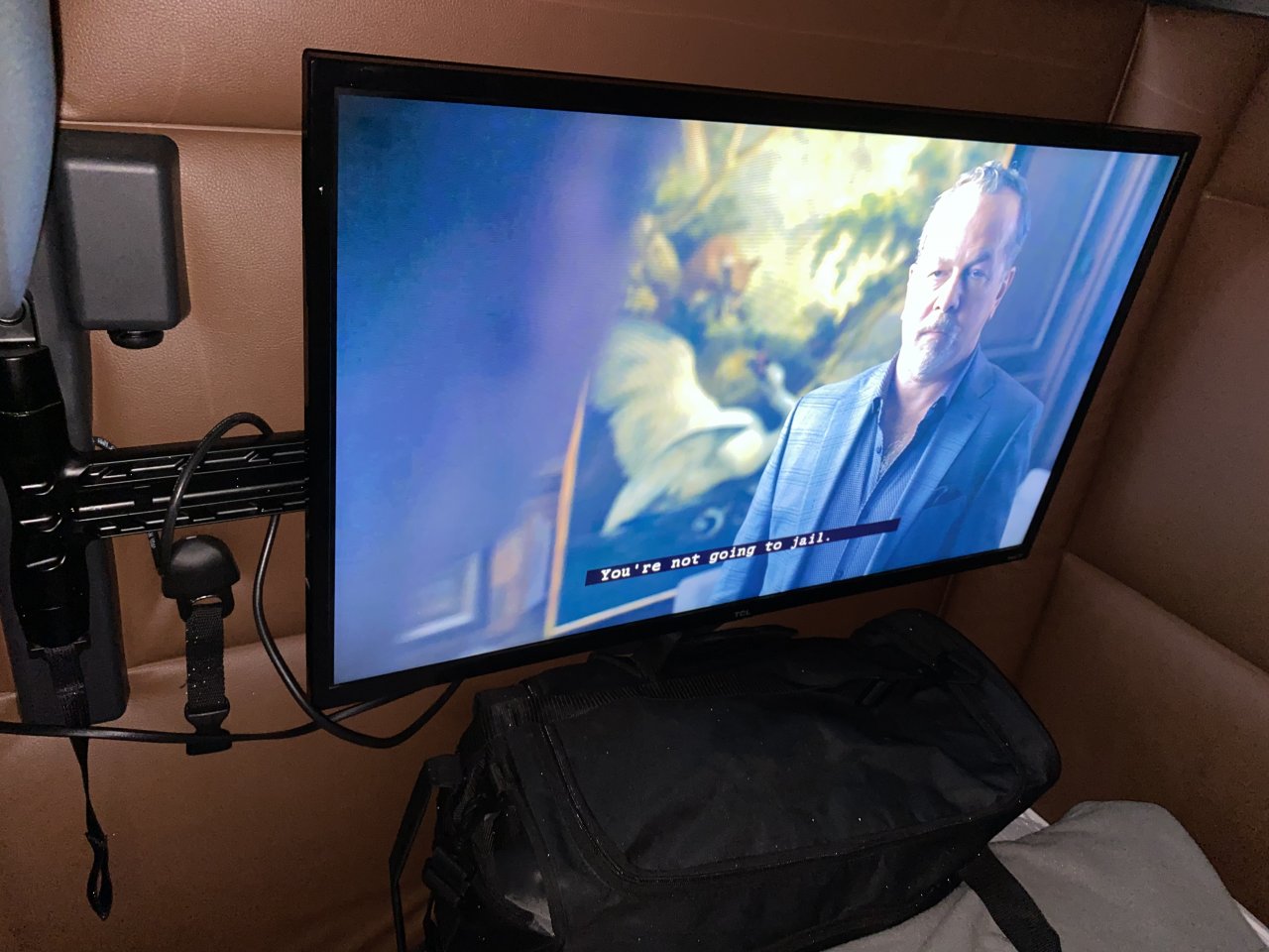

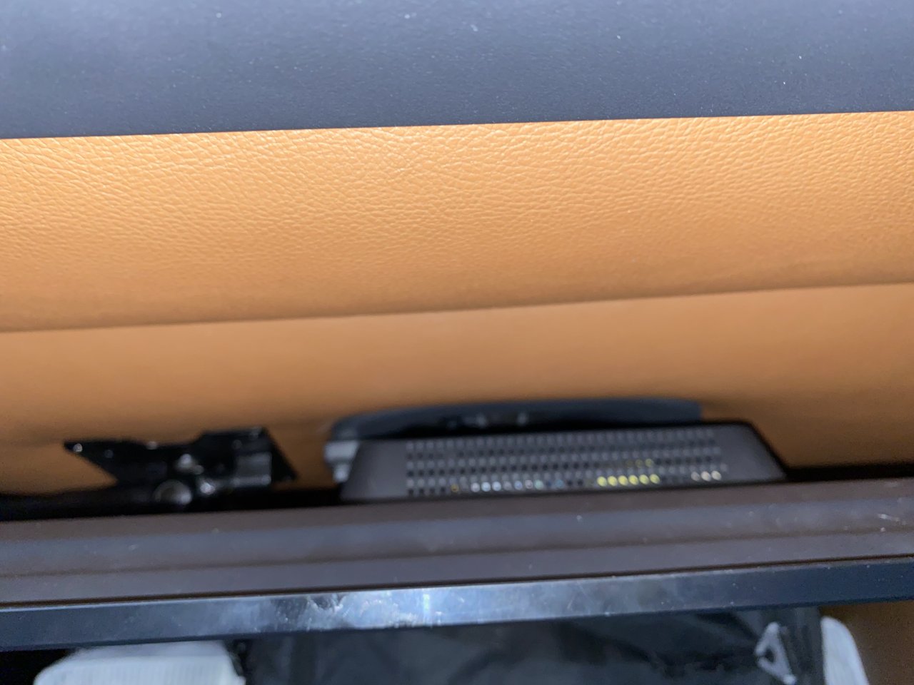

    just use the $9.96 mount from Wally World, the Onn Mount. I attached a SS for reference. You’ll need two extra extra washers to ensure security to the window - you’ll get 4 in the mounting pack. 9D200CE8-9C5D-4120-B734-70DBCC7189EB.png
    I just installed a 32” in TCL in my 2021 Freightliner Cascadia. I’ll give an update when I run the next 1k and see how it holds. It seems secure. The standard manf won’t work because of the microwave cabinet so I used the window bolts. Leaving a bag full of clothes underneath it just in case the freightshaker shakes it off, providing a little graceful impact, with a pillow under it when I’m rolling
    F4C28E48-B5A9-4D76-99BD-F29A7ADB75A6.jpeg A14A3A84-F61A-41CE-93AA-7B560A598CB0.jpeg C3720B3B-5BBE-45A5-9EAB-95A3C6104041.jpeg

    look at the beginning of the thread. Depending on your tv model and how much room is on the back and how high you mount it, you won’t need to pull the T handle off your window bar.
    $10 at Walmart, pull the two window screws, put washers on the star bolts, screw the plate in. Literally that simple.
    Then attach the mount to your tv with hardware, and off to the races you go
