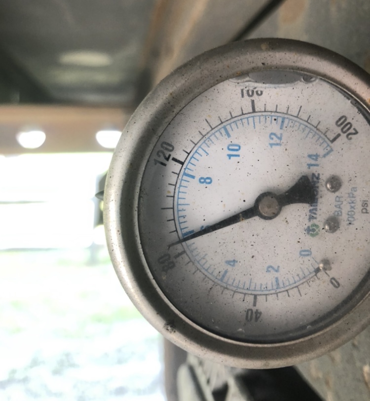

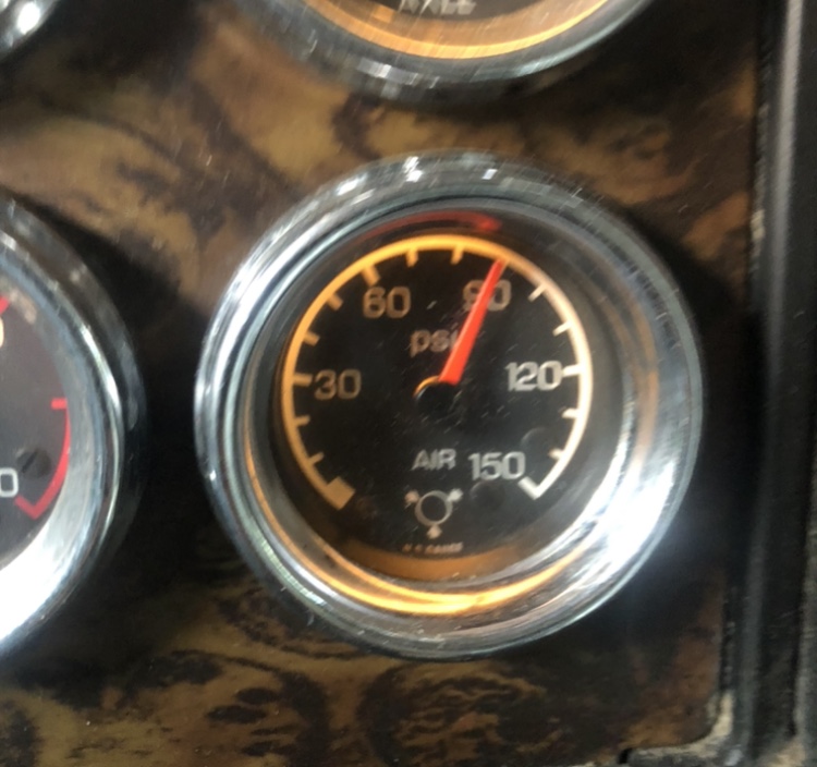

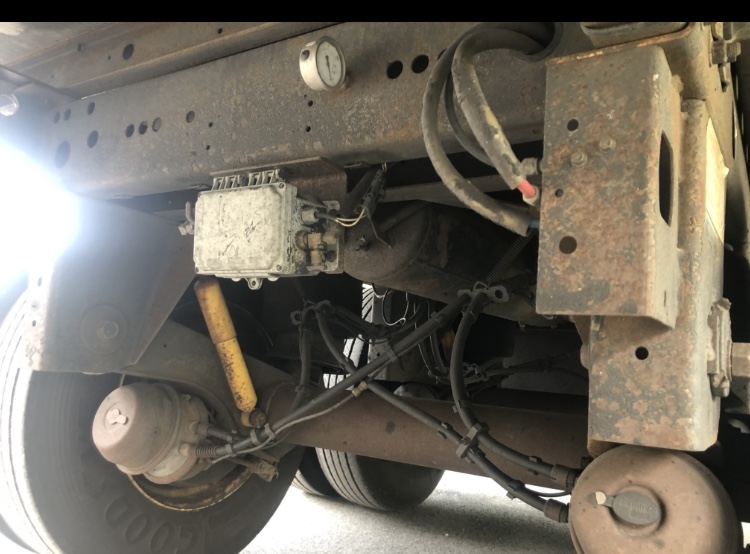

    scale empty, divide weight by psi on guage, 1 psi =xxx lbs
    you can have a factory guage on the dash or you can mount just a water filled guage on a bulkhead fitting pretty much anywhere, my steer weight never changes whether I’m empty or have 40 ton In 2BA6A64D-9595-477C-B805-A82528FA8B2D.jpeg
