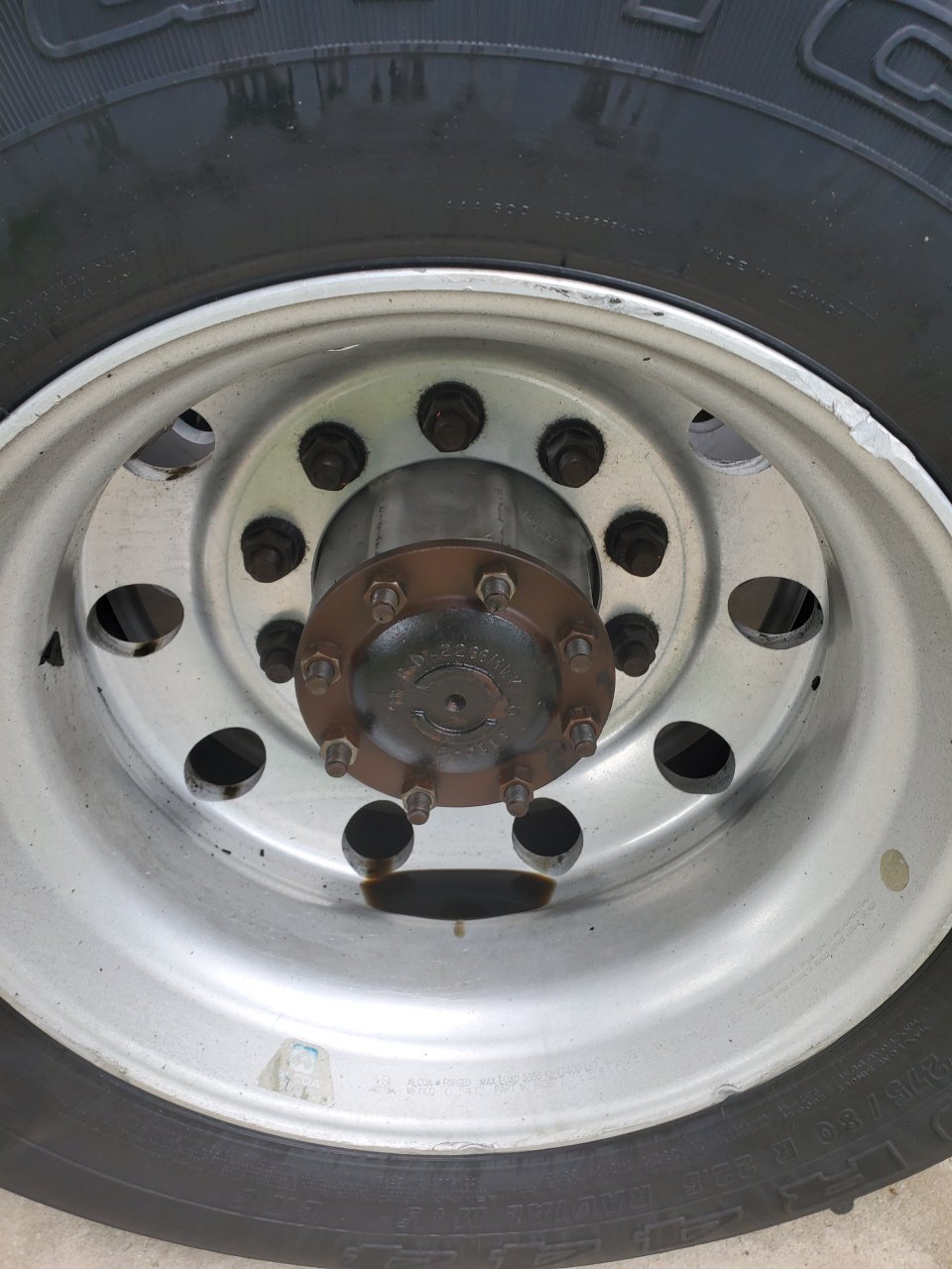

    Posted a photo of my drive wheel it has a leak would it be the hub seal or could it be the inner seal its a 2014 freightliner 20200830_125152.jpg 20200830_125152.jpg

    Looks like the axle seal need pictures of the break shoes to see about the wheel seal.

    It would be the outer one right not the one in the inside of the hub

    Try to tighten up the axle bolts might have backed off mine did that once

    Looks like the axle seal, tighten up the bolts, see if that stops it.

    Fifteen sixteenth socket and good impact 15 minutes and done then check lube level

    I do remember they had a recall a few years ago for Freightliners that had exactly that problem from factory but I couldn't find a link.
