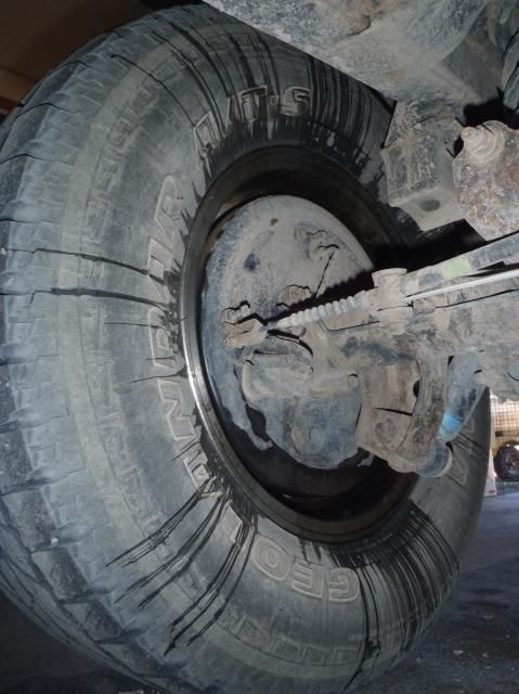

    This pic is on a pickup... But it will look very similar on a truck. This is either a bad hub or axle seal. See how the oil streaks out away from the center of the tire and wheel assembly? If you see this dont let anyone blow you off and tell you its nothing to worry about.
  9. Dave_in_AZ
    61,459
    431,964
    That's stop now lol.

    Lol... Yeah thats a pretty bad leak there... I have nursed a pickup along like that to get to a mechanic to have it fixed before... But I think I bought up most if not all of the gear oil between where I noticed it and the mechanics shop. Stopping very 30 miles or so to add more oil... That was a long day.
