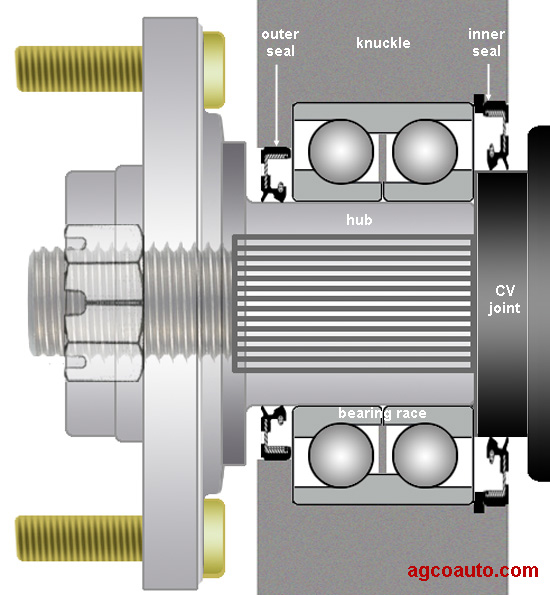

    Here is a decent image. It's probably from a front wheel drive car, but the concept is the same. You have a pair of seals that keeps the hub oil in. but the seals need to be right against a piece of spinning metal, or being spun against a piece of metal as the wheel turns.
    proxy.duckduckgo.com.jpe
    It doesn't take too much for them to start leaking. a bad alignment or out of balance tire isn't going to help. Maybe they weren't put on or replaced just right and they start to leak.
